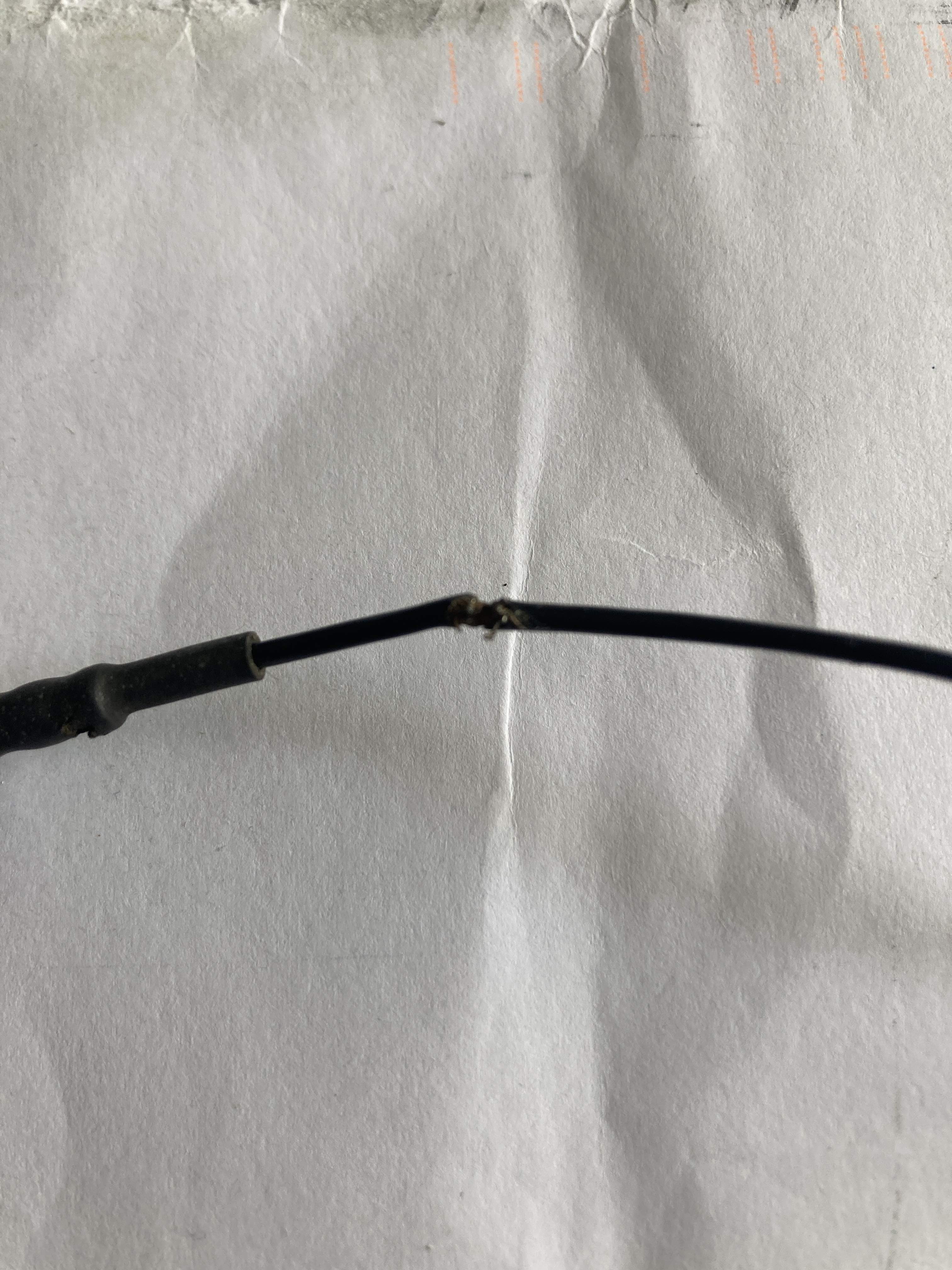

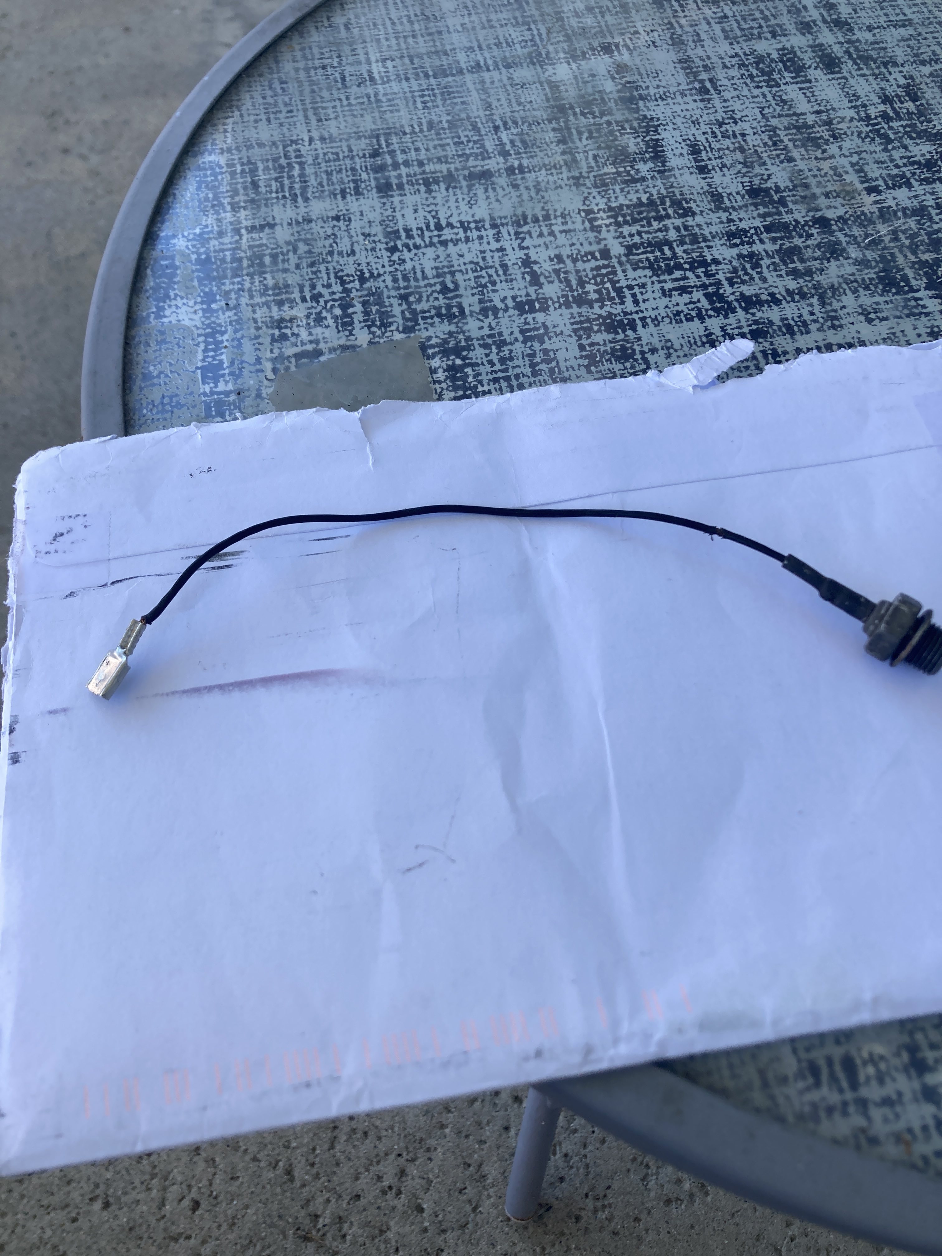

I made the tool needed to remove my CHT and I noticed it had some tape on the connecting wire ,once removed I saw that the air e had been cut a bit so I installed there new sensor expecting the problem might be solved but it was not ,in fact I think the car is back to running rough again with the new sensor . Missed out on a great buy last night for a D-Jet testing box that goes between the car and the ECU that probably would have diagnosed my problem. I guess I am going to need a new wiring harness and posibly another ECU but this is getting expensive .
I checked my IR thermometer against the water boiling pot I have and when the water is boiling (212 F) the gauge only is reading 196F
Tested the old sensor
Cold@81.5 F = 1.149kohms
Hot @ 212 F 220 ohms but starts rising fast as it cools ,went to 244 F in ~ 1 minute .
Currently the new sensor is in the car . I was hoping the new sensor was going to be the fix . Not sure which direction to go at this point .

Ron914   I made the tool needed to remove my CHT and I noti...   Aug 25 2025, 12:30 PM
