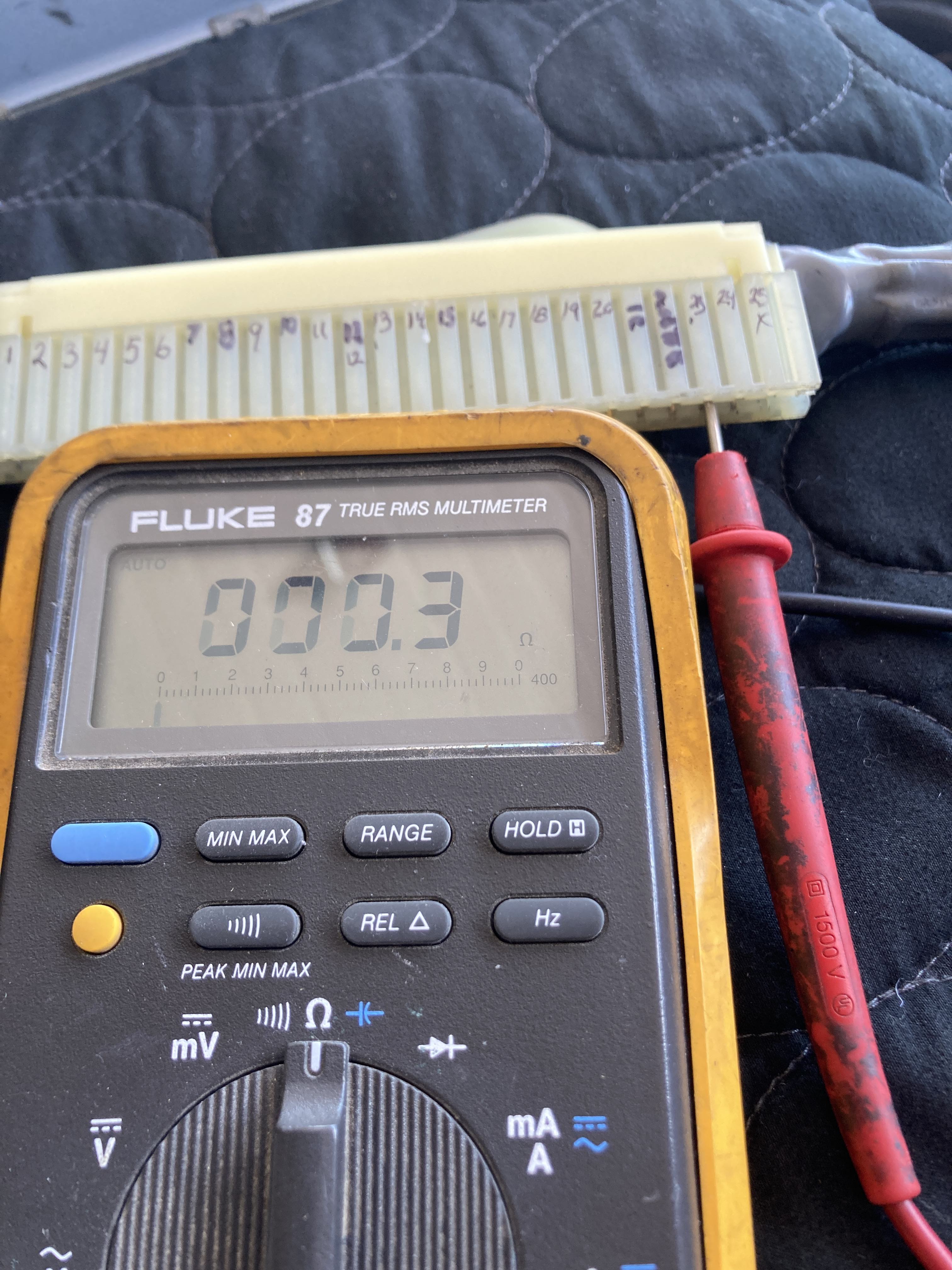

I decided to verify the condition of the CHT wire #23 @ the ECU plug and it looks fine .
I think I am going to look into purchasing a new meter as I have had the one I am using for many years now , maybe the leads are bad but my readings are not what I expected .
Maybe I might need a new ECU . I tried the sniff test but it just smells like old 50 year electronics to me can't really say if it has a burned smell or not .

Ron914   @Superhawk996 I made the checks you requested and...   Aug 19 2025, 10:39 PM

Ron914   I made the tool needed to remove my CHT and I noti...   Aug 25 2025, 12:30 PM
Ron914   I decided to verify the condition of the CHT wire ...   Aug 25 2025, 12:46 PM
Superhawk996   Flukes rarely go bad New leads are much cheaper ...   Aug 25 2025, 12:59 PM
