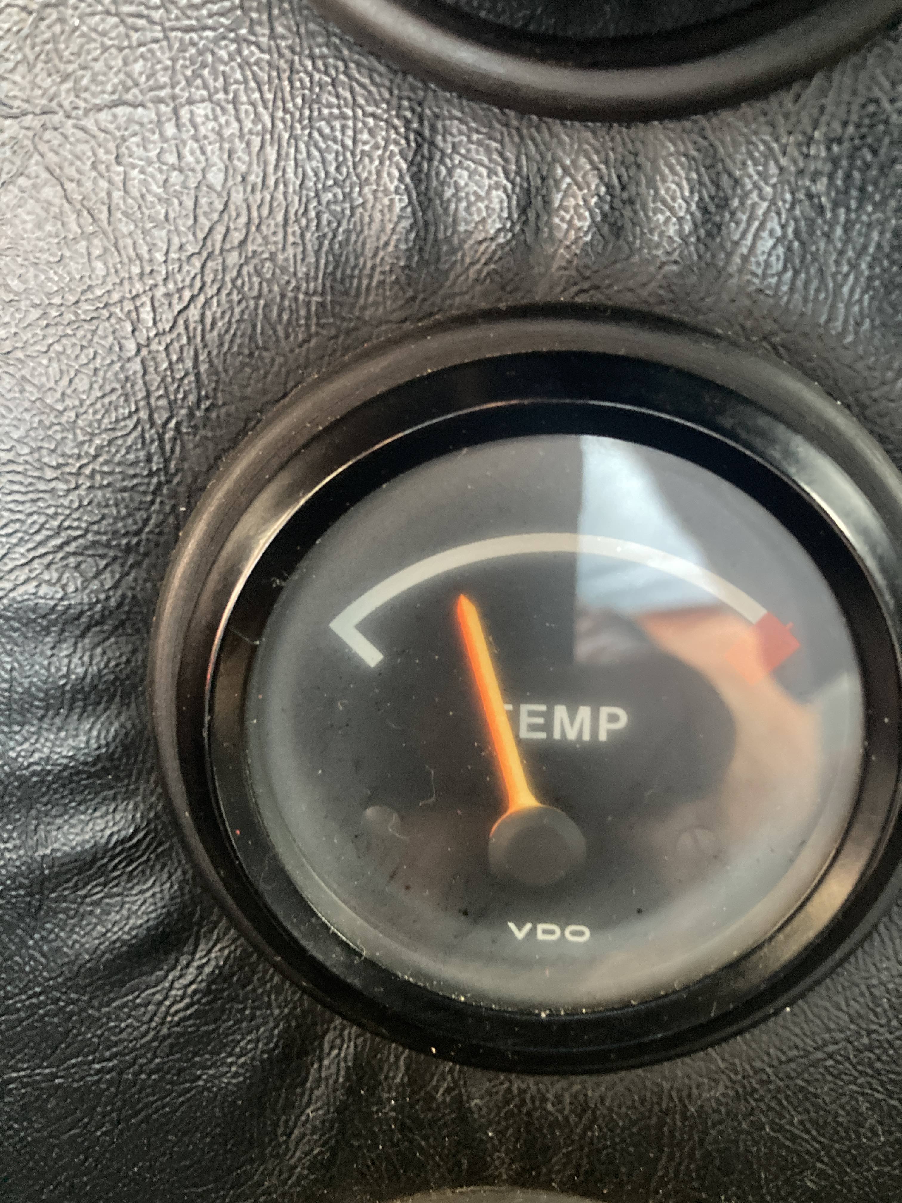

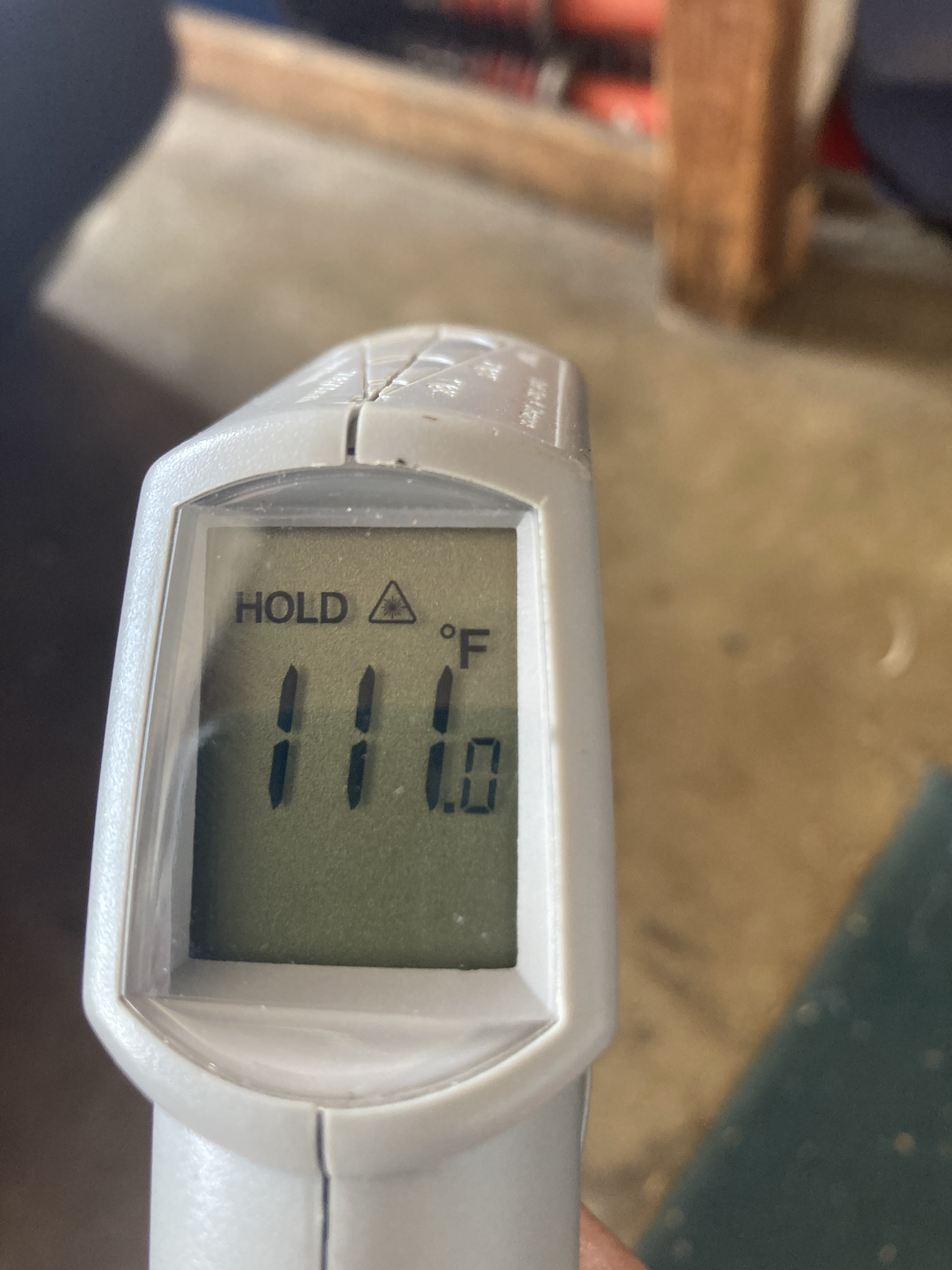

Yes the car is still stalling after 5-10 minutes of running .
Car starts right up , goes to 1400 rpm as it should with AAR open .
I am definitely bothered by the temperature readings , something not quite correct . I boiled water in one of those instant heat tea pots and when boiling the IR just is off by ~ 16+ degrees .
I take the head temp readings at the intake bolts on the head that are exposed and the oil temperature at the oil sender(taco plate ) fins bottom of motor.
Here's a photo of my oil temp gauge vs the IR thermometer( which might be close to -16 degrees off) . My oil temp sender has 200C stamped on it .

QUOTE(Ron914 @ Aug 25 2025, 03:44 PM) *
IR temp sensors are sensitive to what the emissivity is set at.
Silver surfaces are usually a little low. So not surprised by the 16 degree variance. Emissivity of Aluminum is all over the map. Better if you could get a reading off the black steel taco plate where the oil temp sensor lives.
Remind me. . . Did you ever check under your tin for mouse houses? Borescope works great but can also be done wire small inspection mirror through spark plug holes
Also remind me - did you have cooling flap position verified?
What is the new CHT measuring when the engine stalls? Is that the 0.3 ohm reading?

QUOTE(Superhawk996 @ Aug 25 2025, 04:54 PM) *
Motor was rebuilt so no mouse issues.Flap position is open but the thermostat that operates it is not working so flap is kept open all the time .
the 00.3 ohm is the resistance of the wire from the CHT connector to the ECU pin 23, I wanted to make sure I had a good wire going t o the sensor . The car is so all over the board , I went out to start it up for a test so I could give you those values but now the motor does not want to run again ( very rough idle and stalls )
