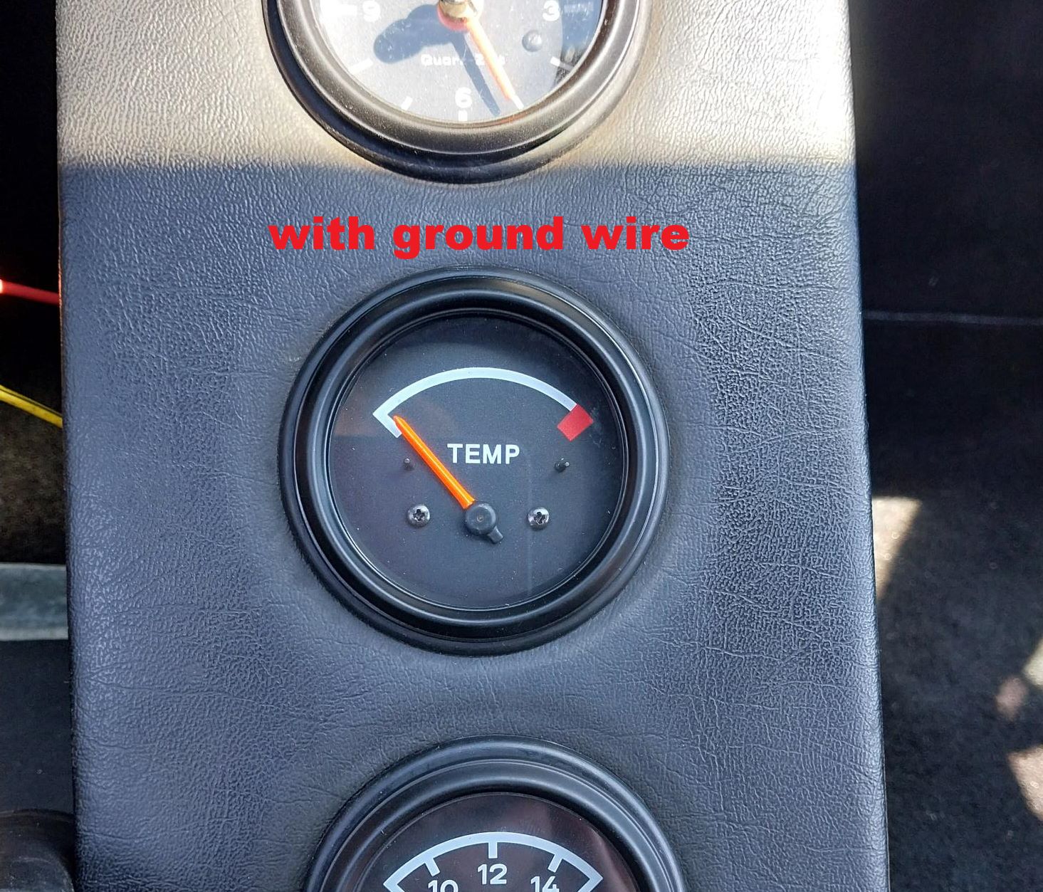

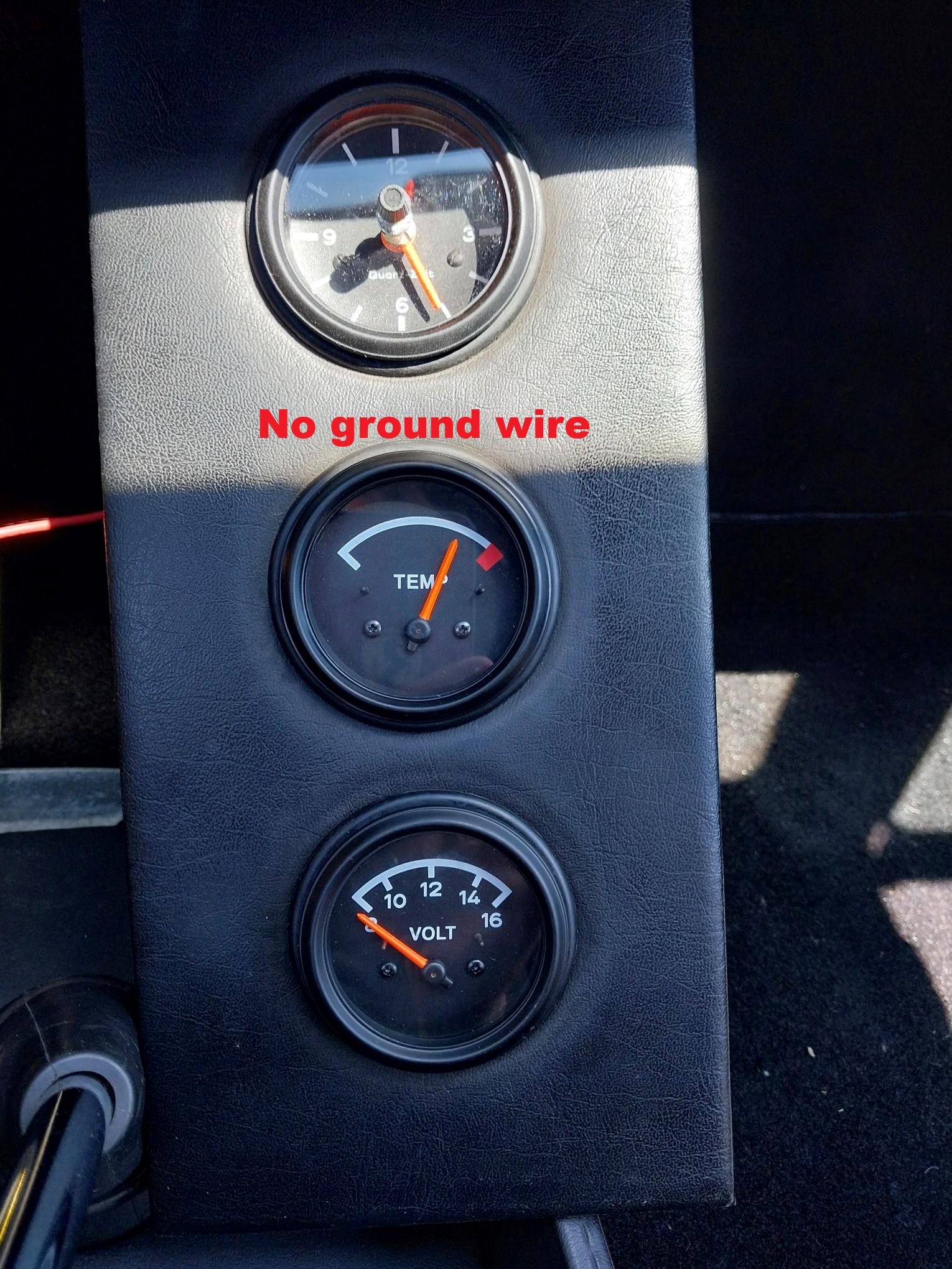

Yes Bruce, you were all over it. This morning, I ran new wires from the sender to the gauge and from the gauge straight to ground. I let the car idle for about 5 minutes and almost nothing. I started moving wire around on the back of the gauge and I noticed the temp went way up. That was with the ground disconnected. So, it appears I have a bad ground. Then I realized that my voltmeter wasn't working either. I hooked up the new good ground and now it works. Tomorrow, I'll redo the ground, and it "should" be fixed.
Thanks for all the responses and support.
Photos are after idling for 10 minutes.
