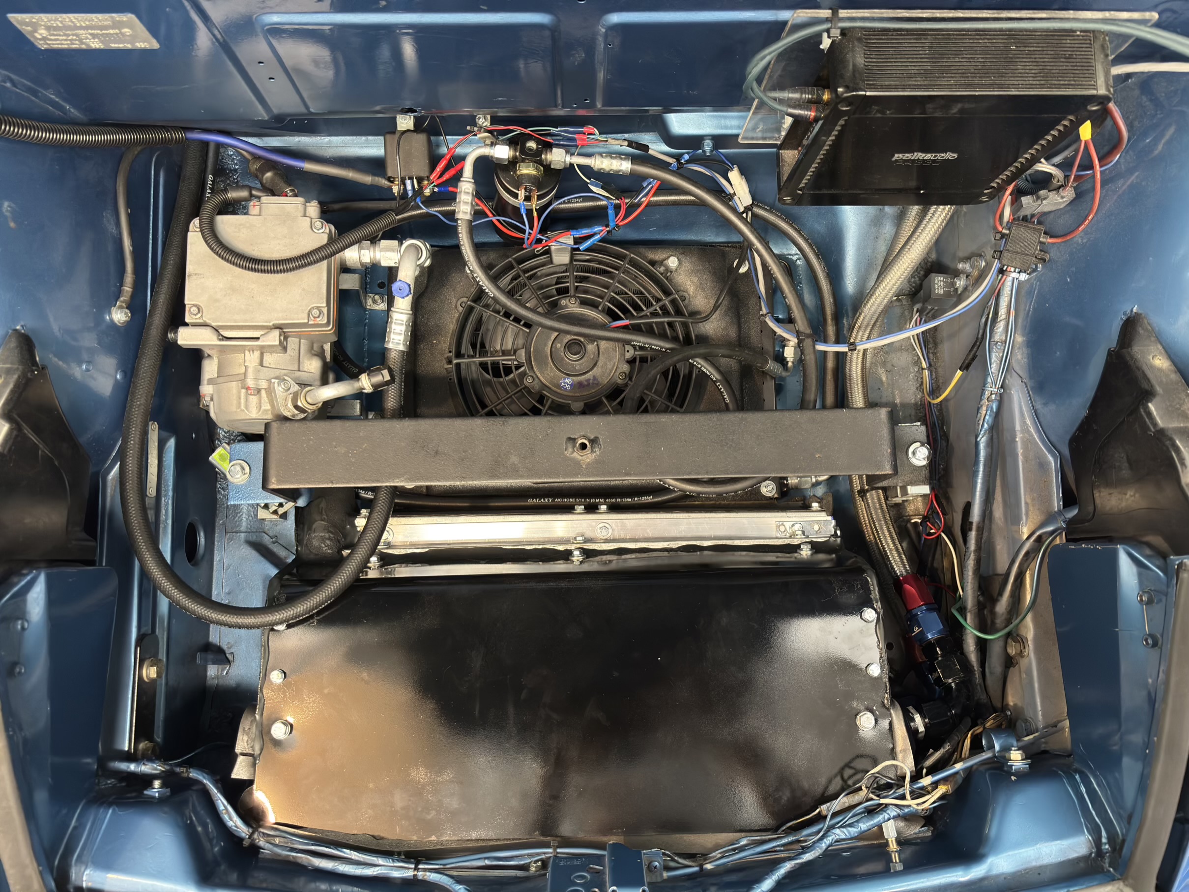

OK..I've read a bunch of semi-recent articles online regarding electric air conditioning kits in cars. One was a 911 that is employing a rather pricey euro-kit and the owner seemed pleased... Most articles focus on the large current draw and the overall (in)efficiency of the kits on the whole. Yet, I can't help but feel that the 914 (tiny car) is a perfect application for such a kit - particularly if your engine can push a larger alternator. (Mine is a v6 and would have no problem doing so).. Allows you to frunk-mount the compressor and simplify the overall install (yes, big gauge wires are required, but in my case at least.. no interior exists so no worries)
Plus relatively cheap kits are waaay-abundant.
So thoughts, insights, experience? (IMG:style_emoticons/default/idea.gif)

@Steve
Steve - Where are you mounting the condenser and fan?
Steve
post Aug 28 2025, 11:05 PM
Posts: 6,130
Joined: 14-June 03
From: Laguna Niguel, CA
Member No.: 822
QUOTE(mepstein @ Aug 28 2025, 07:07 PM) *
@Steve
Funny but I have played around with mounting a Griffiths condenser in front of the oil cooler with typical spal fans pulling air through the cooler and a floor mounted condenser and fan. I think the Griffiths condenser worked better and takes less room in the trunk. It’s all about the cooling capability of the condenser and air flow through the condenser That’s why some people that have the CR electric setup run two condensers.
Griffiths condenser https://www.autohausaz.com/pn/16052626-9115...PYaAiqMEALw_wcB
Southern rods condenser https://www.southernrods.com/cooling-and-he...-fan-combo.html

Steve   I did some more testing at 70 degrees in the garag...   May 29 2025, 09:52 PM

Steve   The only issue I am dealing with now is I used a 4...   Aug 29 2025, 09:44 AM
Dave_Darling   ... I used a 4 gauge crappy non copper Amazon Chi...   Aug 31 2025, 11:50 PM
Steve   ... I used a 4 gauge crappy non copper Amazon Ch...   Sep 1 2025, 09:52 AM

Steve   I was recently looking at the Southern Rods web si...   Nov 22 2026, 11:53 AM
mepstein   Steve - I thought you had the Griffiths condenser ...   Nov 22 2026, 12:07 PM
Steve   Steve - I thought you had the Griffiths condenser...   Nov 22 2026, 12:24 PM
