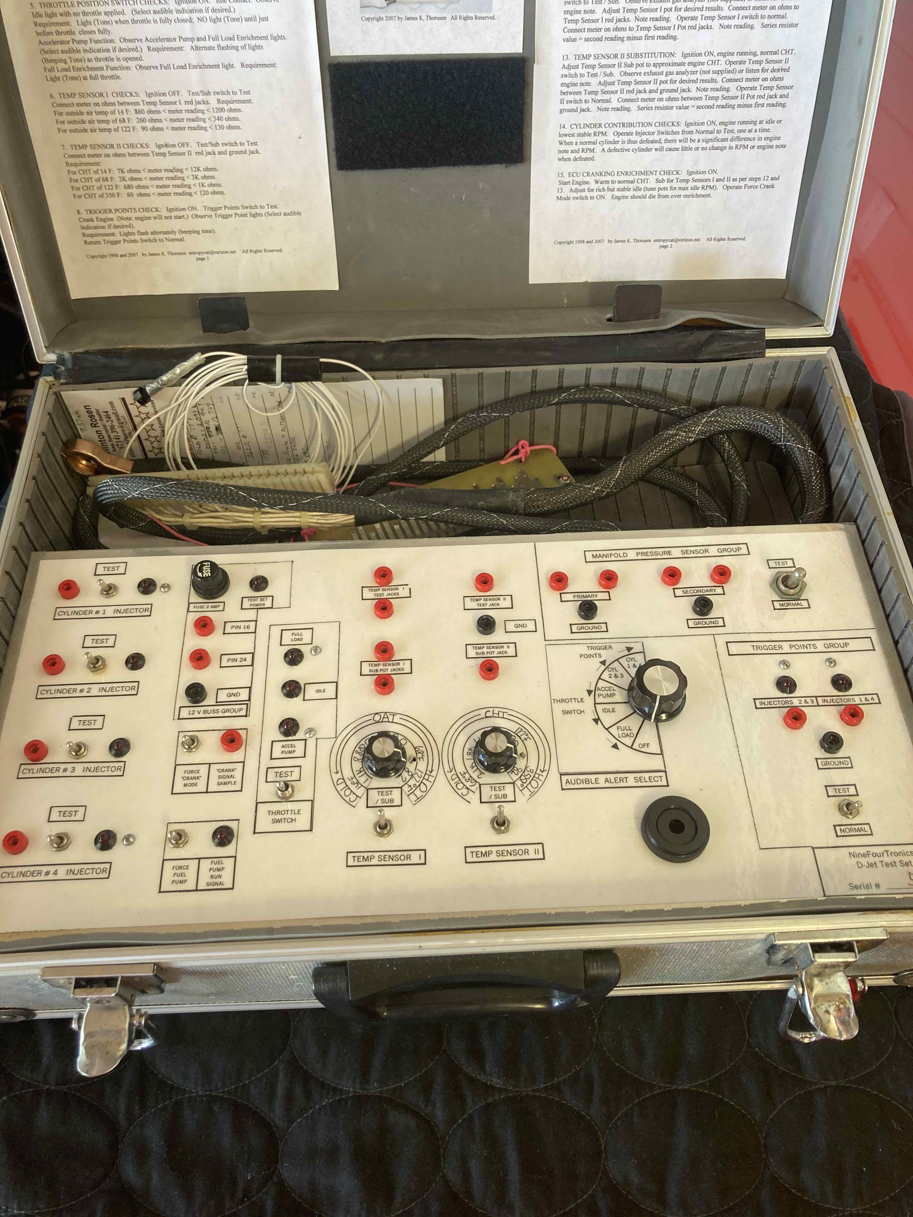

Well I purchased this test device for D-Jet from a member here . Although I have tested with my DVM these connections /values it really made it easier to take the readings .
I noticed when I checked my fuel pressure after 5 minutes I had a loss of 2 psi , not sure if this indicates a leak somewhere but I do still have a gassy smell inside my car . I have replaced the old plastic lines with SS ones and all fuel hose has been replaced with Cohline braided hose from the bird . The fuel tank was also removed and checked but I did not do a pressure test on it , the gasket inside the fuel cap was also replaced .( this is a separate issue and doubt it is the reason for my engine cutting out at 212F) .
