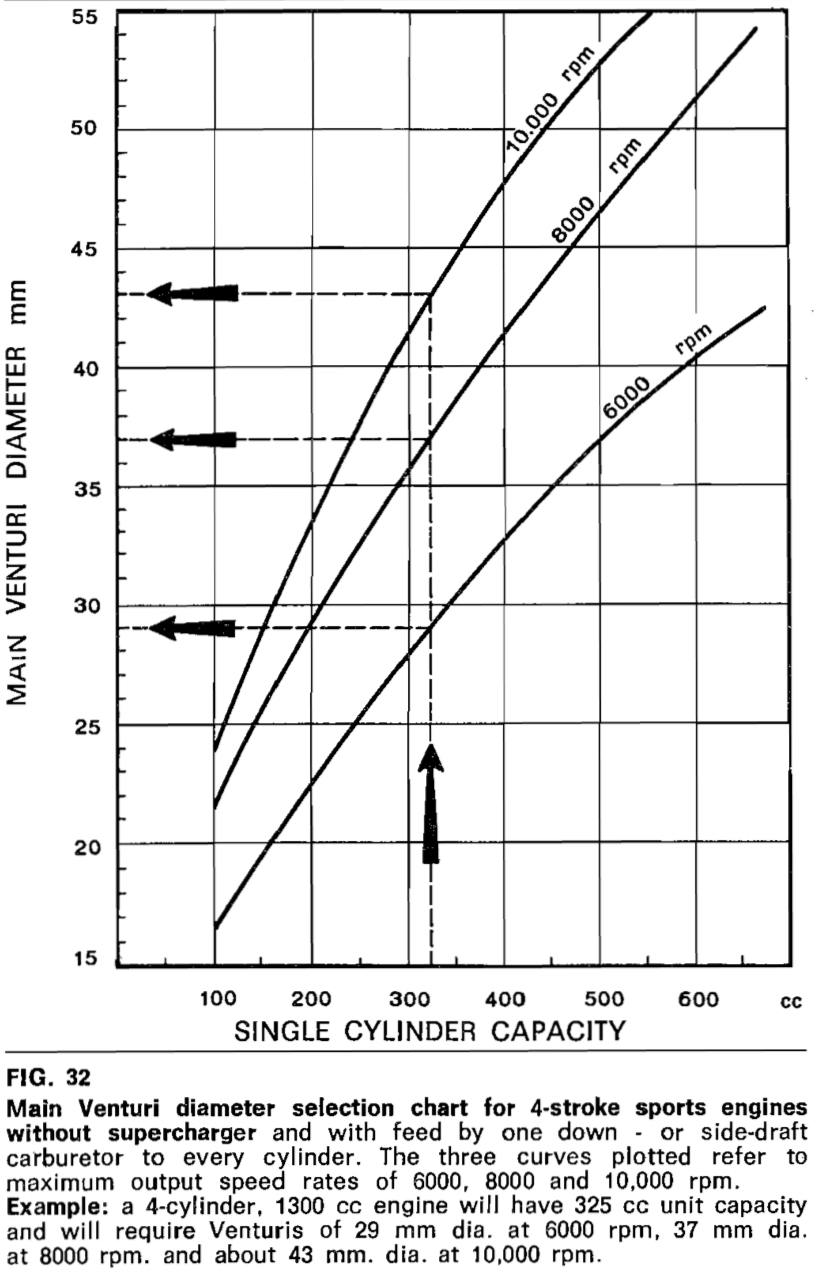

Keep in mind that much of the advice you’ll get on carbs is aimed at maximizing horsepower . . . Even if that means diminished drivability.

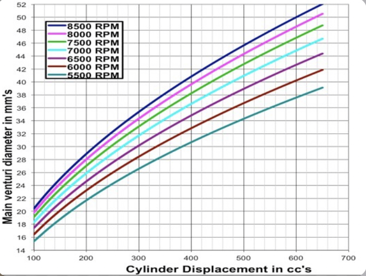

I post this chart often - it’s is a pretty common set of curves that aligns well to recommendations both in the Weber tuning guide as well as several of the published tuning books for Webers and Dellorto’s.
The thing is - this chart is for HP. If you use this for tuning street drivability the tuning will suck due to picking a Venturi that is way too large (like 34-36 mm). I know . . . Cause when I was young I thought I wanted to maximize HP. But it turns out - we don’t drive around on the street at redline. Go figure. Took me a lot of years to learn this the hard way.
And here’s the one from the Weber tuning guide
When tuning the first thing to pick is the Venturi - that sort of determines everything else. And if the Venturi is too large, you don’t get a good vacuum signal and everything else sort of goes to (IMG:style_emoticons/default/stromberg.gif)
As a generalization: People over-carburate and then wonder why they have poor drivability. I had to learn these lessons myself the hard way.
