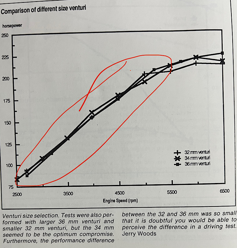

I think it’s probably also worth posting this from the 911 Bruce Anderson book.
If you look at the difference between the 32mm & 36mm Venturi - you’ll see that there is no difference in HP until you get to the very top end.
But you can be sure the 32mm will offer far better driveability in day to day, street use.
