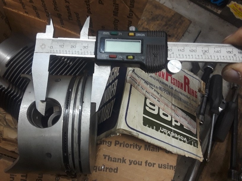

I was digging through a storage tote and found a set of NPR 96mm pistons and cylinders.
Is there a difference between one that fits a 1.7 vs a 2.0?

QUOTE(zig-n-zag @ Feb 19 2025, 07:08 PM) *
I measured the wrist pin to the piston top for a 90mm (1.7L) piston and it’s 42mm.
I assume the 93mm (1.8L) piston would also be 42mm.
The 94mm (2.0L) piston is at 35.6mm.
The rod length center to center for the 1.7 and 1.8L is 127mm
The rod length center to center for the 2.0L is 131mm.
So the 96mm (2.1L) piston for the 2.0L rod/crank would also be at 35.6mm
& to clarify that would be from wrist pin center-line to Piston top (IMG:style_emoticons/default/sunglasses.gif)

zig-n-zag   I measured the wrist pin to the piston top for a 9...   Feb 19 2025, 08:08 PM
914werke   I measured the [u]wrist pin to the piston top for...   Sep 15 2025, 12:53 PM
914werke   Note: the 96mm barrels (P&C kits?) that will...   Sep 15 2025, 01:13 PM
cgnj   NPR slipper pistons were a thing in 80's and 9...   Sep 15 2025, 01:31 PM
Dave_Darling   There were kits sold for 1.7s that did not require...   Sep 15 2025, 02:49 PM
