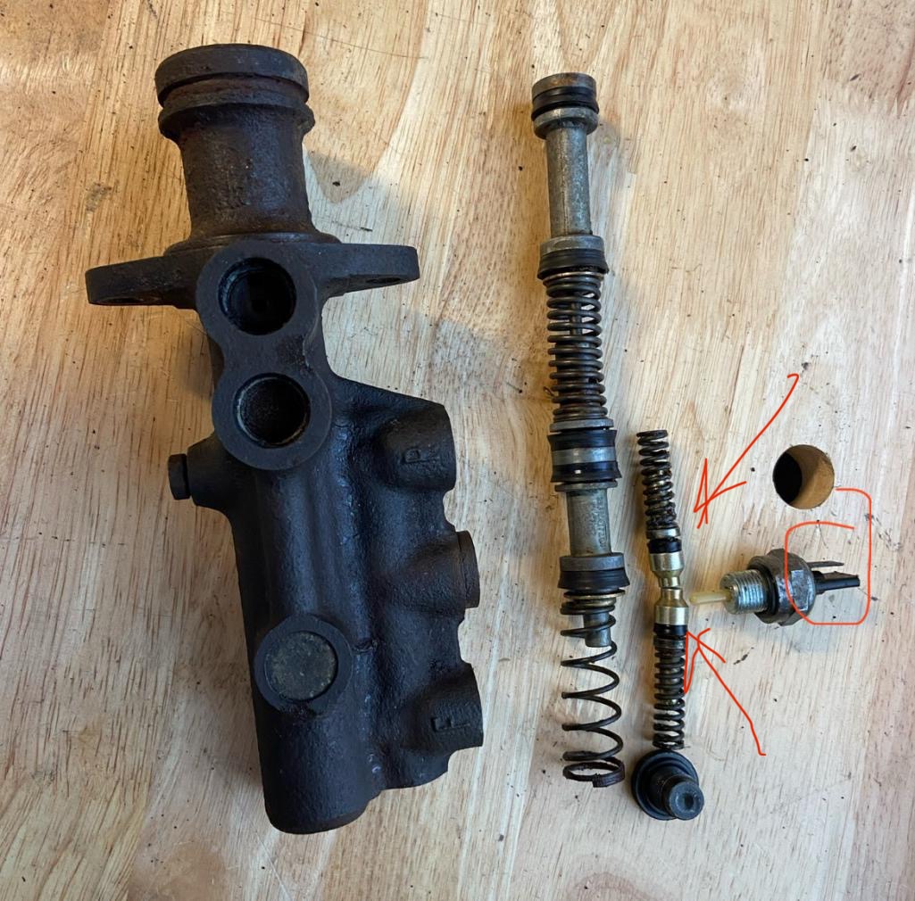

Discovered a fluid leak at the brake switch in the Master Cylinder (19mm).
Two questions,
What kind of washer is between switch and MC? Metal/fiber?
If I take the switch out will I loose the brake fluid?

Master cylinder failing doesn’t make a noise - the seals within just start leaking internally and bypassing pressure
If the fluid is on the switch - make sure it isn’t just leaking from the supply line grommets at the top of the m/c and dripping down onto the switch. There was also a bad batch of 914Rubber master cylinders that were prone to leaking at the Welch plug up top and that conceivably could leak down onto the switch too.
The switch itself and its plunger / actuator is in a dry section of the master cylinder between the seals. You can remove the switch without losing brake fluid. However, if you find fluid inside, it’s a sure sign the seals on the pressure differential piston(s) have gone bad.
Here’s what the internals are:
Arrows pointing to the differential pressure piston seals
