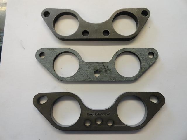

How are people fitting the Ljet intake manifolds to work with 2.0L heads? FWIW this will be on my 2056.

Take the 1.8 runners and drill 3rd center hole. You should be able to bolt on 2.0 spacer block on and use it as a pattern for hole.
The other 2 holes will also need to be enlarged as they are in slightly different locations.
