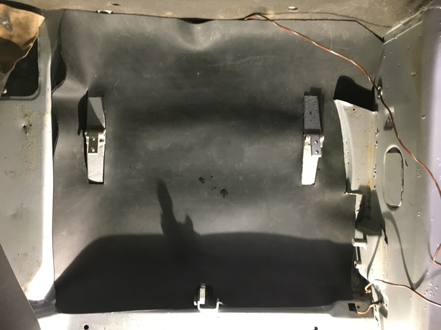

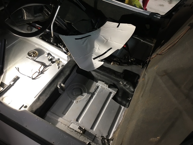

Well here’s how it went on the install.
Almost 3 years later, and speaking with George, and his team, again.
“ we sell an exact cut factory duplicate floor pan tar kit designed from original factory pieces we had for years. six pieces, just heat and beat to install”
Just a few of many concerns, after inquiring, ordering, and then receiving these:

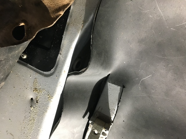

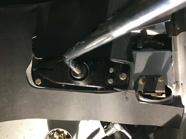

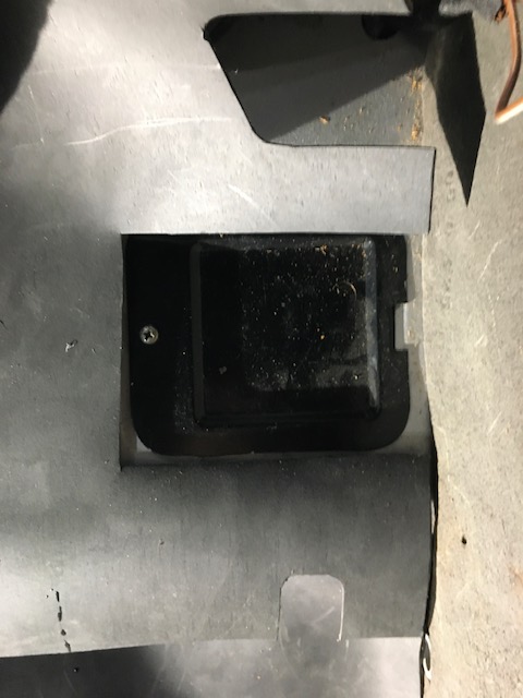

They are to large, every corner would have to be cut, and all sides trimmed. I fitted, starting with alignment to the seat brackets. The center console piece, is to small of a cut to clear the access tunnel door. Along with the large winged notch for the seat belt hole. Notice the shifter cut out. In places on comparison with factory, the material is too short.
In hoping this is a one off kit, when I inquired, I was now told by AA,
“ it will require trimming to install”
Be aware these are not “exact cut factory duplicate” not able to “ just heat and beat to install”
I honestly, would not have purchased these if I was informed of the facts. I have not, and may not installed these, there back sitting on the shelf.
