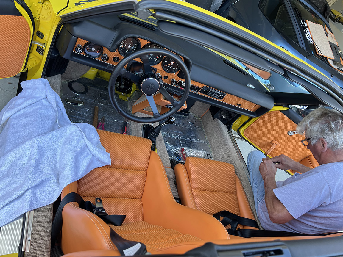

Garland   Well here’s how it went on the install. Almost 3...   Sep 22 2025, 09:07 AM

Superhawk996   To be fair the wording on their site is “Custom ...   Sep 22 2025, 11:10 AM
mepstein   To be fair the wording on their site is “Custom...   Sep 22 2025, 11:33 AM
Superhawk996   To be fair the wording on their site is “Custo...   Sep 22 2025, 11:37 AM
