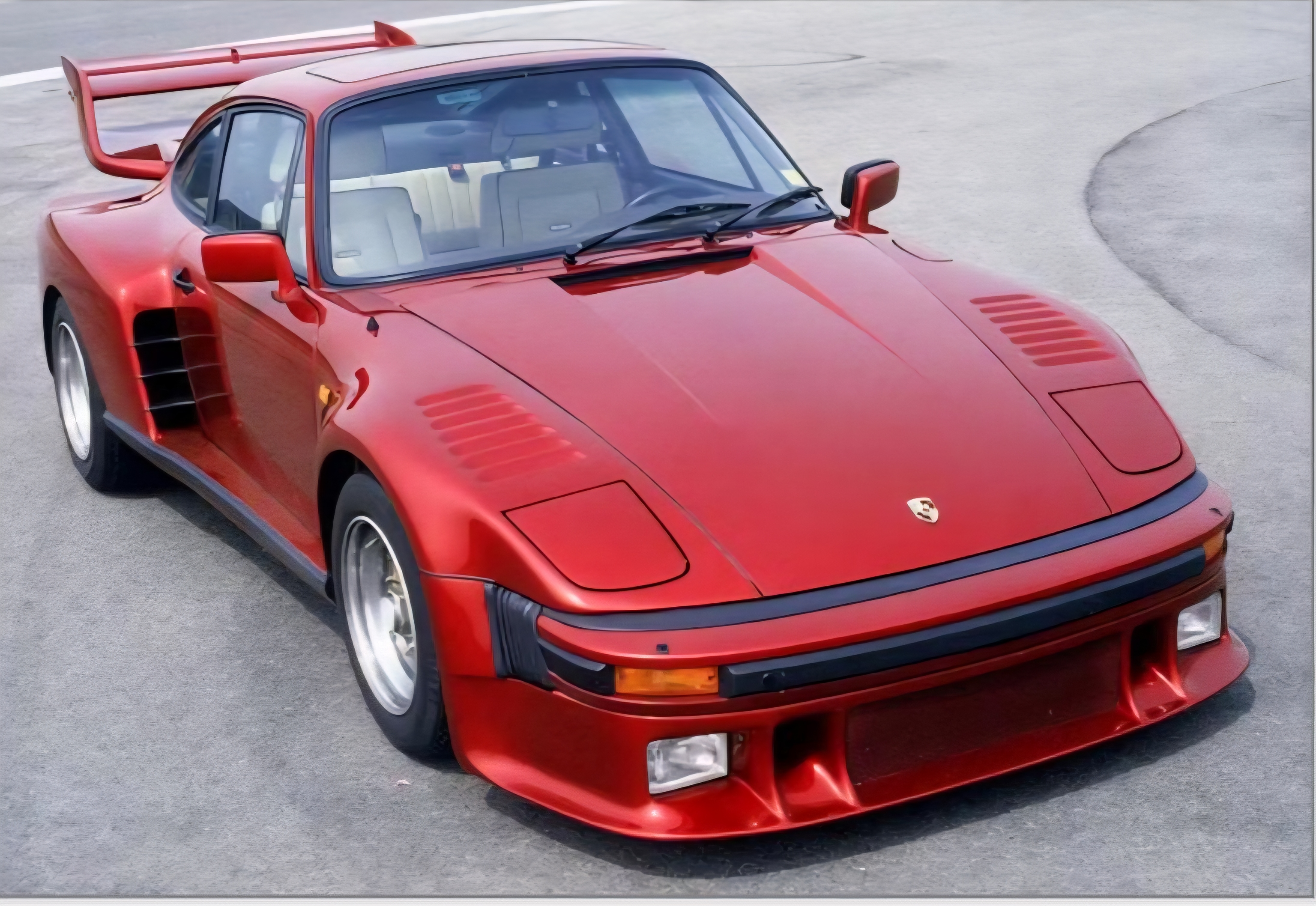

As for the headlights, seems like a no brainer in all aspects (location, height, fit). Reminded me of this look, close body color too.

QUOTE(Montreal914 @ Sep 20 2025, 09:04 AM) *
Extremely scary to see that modified cars like these are actually on the road (referring to the front body strength, or non-existance thereof). (IMG:style_emoticons/default/blink.gif)
Clearly it is in great hands to bring it to the standard it deserves. Love watching the fabrication process. (IMG:style_emoticons/default/first.gif)
Mansour Ojjeh's / Porsche factory 'Sonderwunsch built 935/street version. He actually sold it off many years ago at auction.
He was a Big part of the Porsche TaG Heuer F1 effort.
