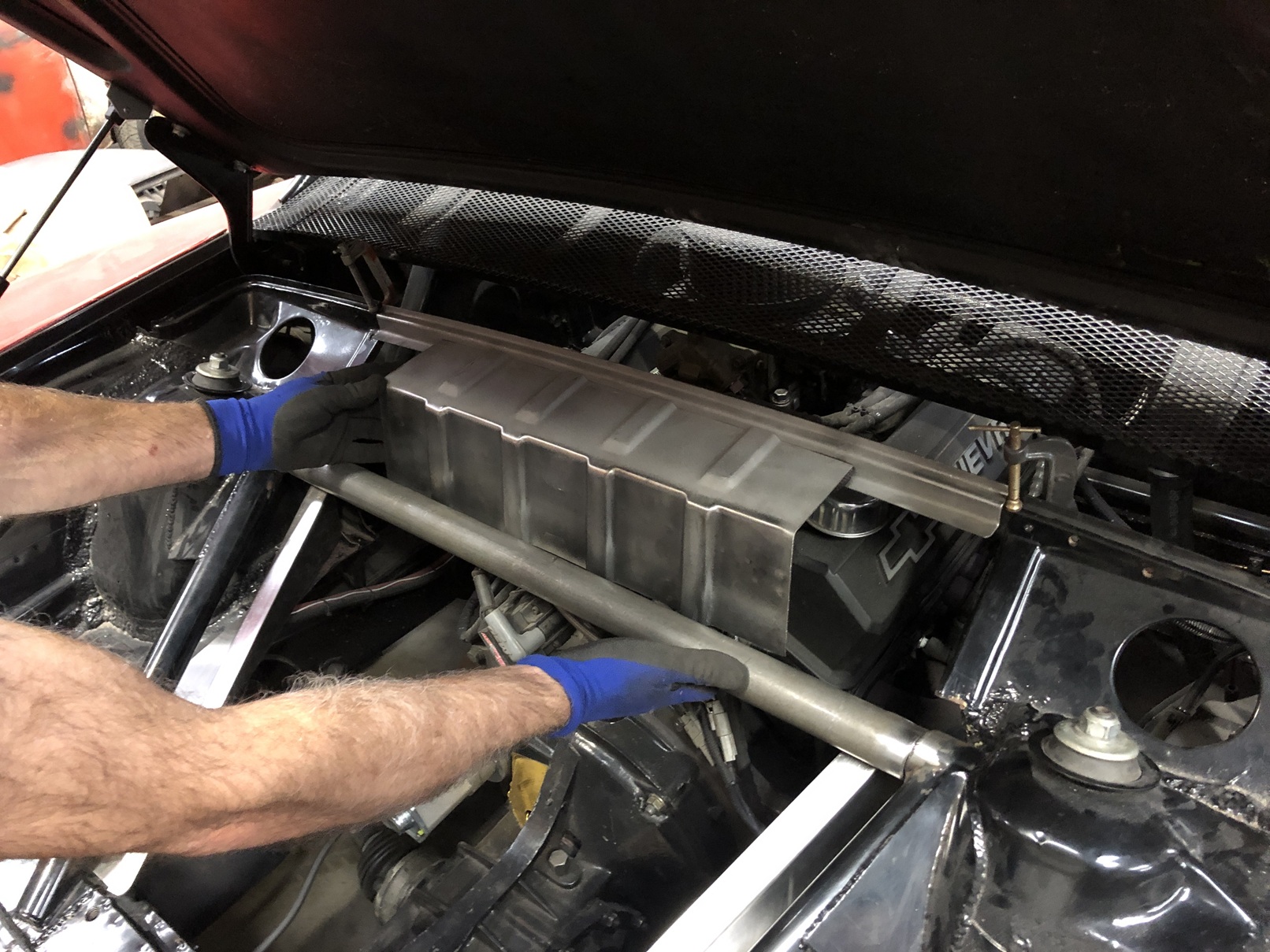

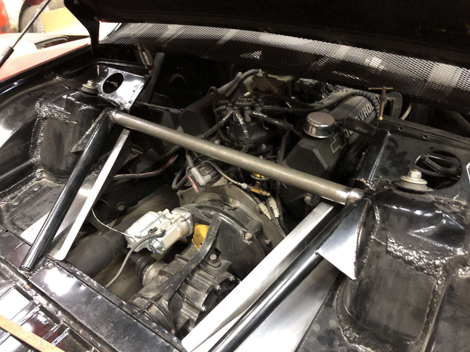

Fitting the replacement section of the tower crossbar and an early look at the removable upper section of the engine cover. It's coming along nicely.

tygaboy   Fitting the replacement section of the tower cross...   Sep 24 2025, 12:45 PM
Shivers   Fitting the replacement section of the tower cros...   Sep 24 2025, 04:10 PM
tygaboy   Fitting the replacement section of the tower cro...   Sep 24 2025, 05:06 PM
