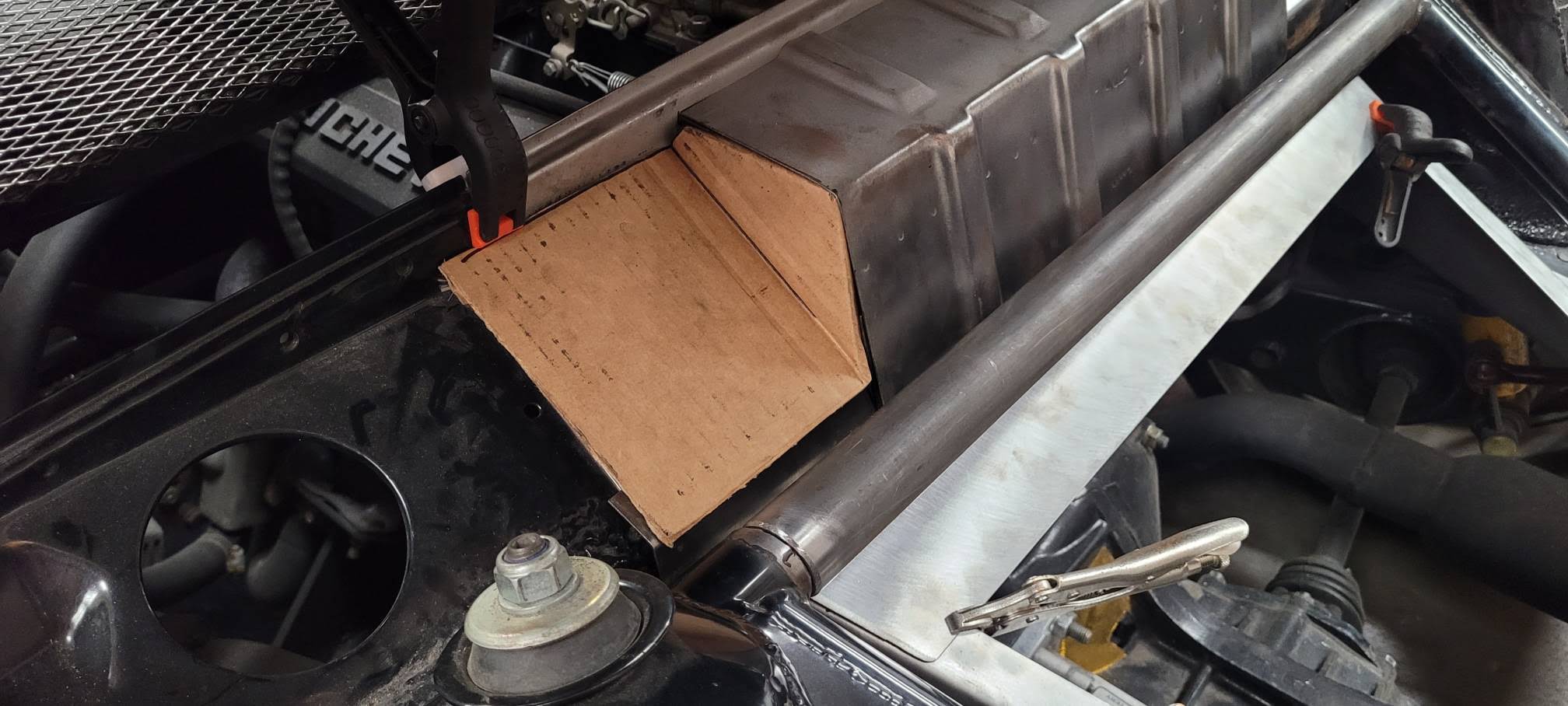

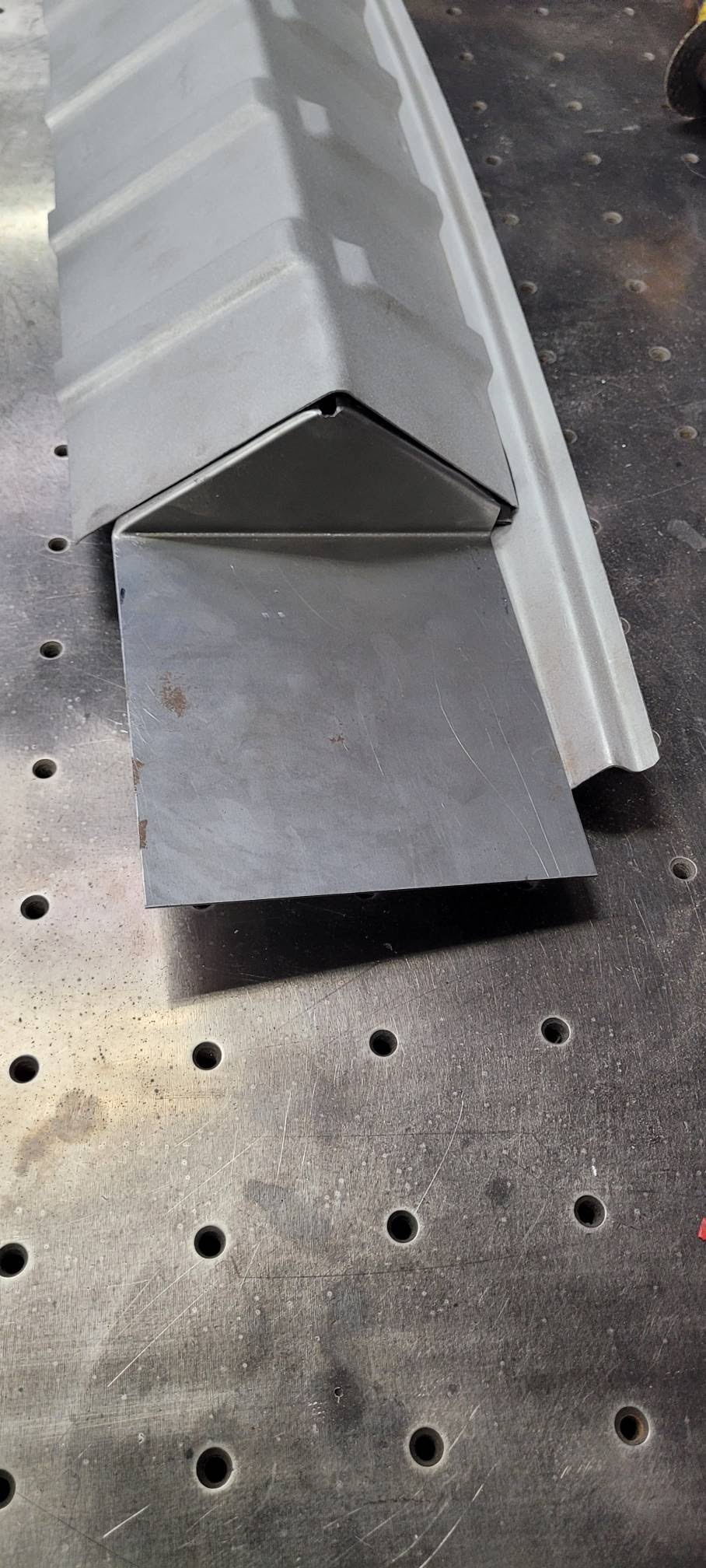

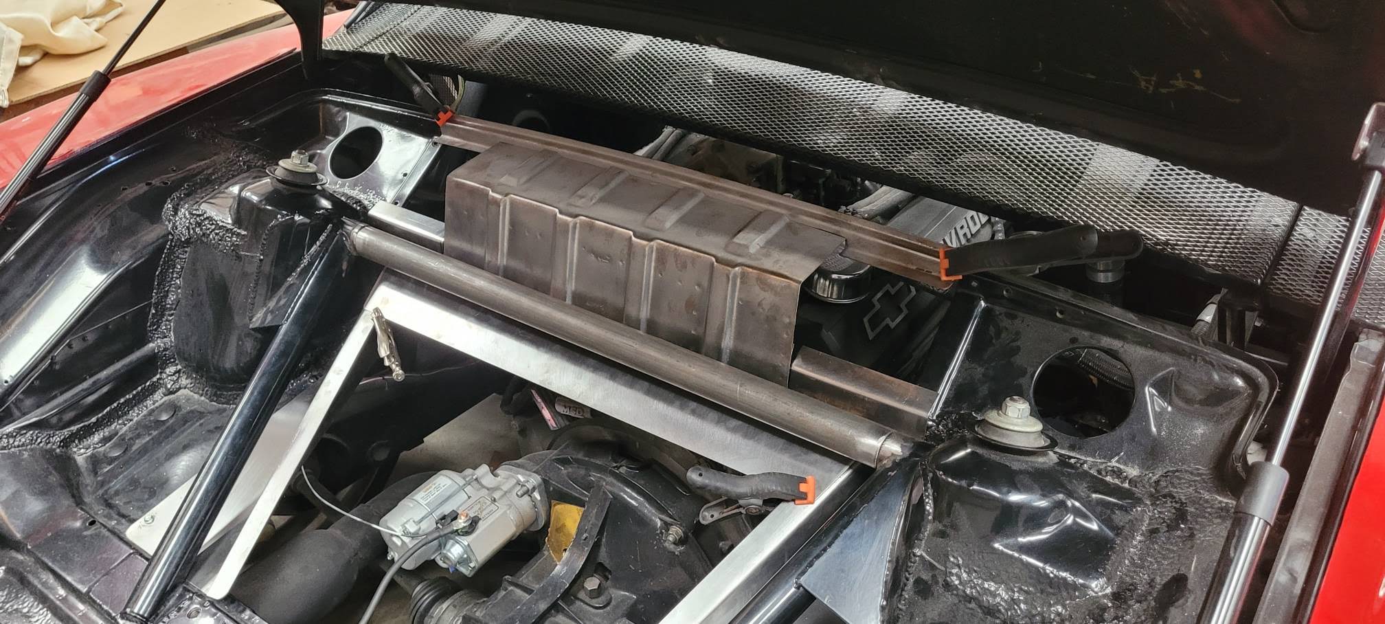

tygaboy   If you follow the videos, you'll remember the ...   Dec 22 2025, 03:21 PM
tygaboy   The car arrived with no shrouding from the nose to...   Dec 22 2025, 03:26 PM
mgp4591   The car arrived with no shrouding from the nose t...   Dec 22 2025, 10:25 PM
Dave_Darling   It's still early for me--I was trying to figur...   Dec 23 2025, 01:24 PM
