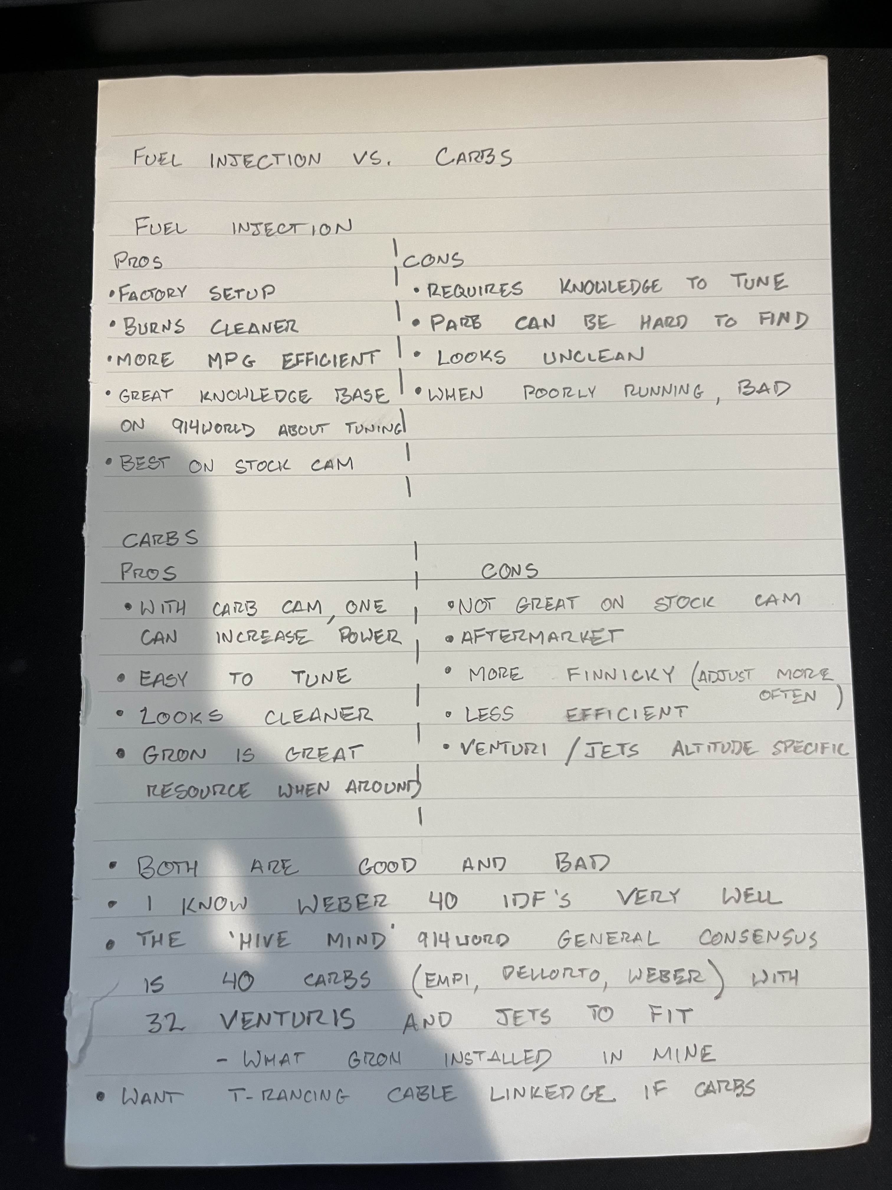

Okay update that changes things a bit - the engine is going to be put in by the shop that works on my dad's 911 (and has for decades, family friends we trust). Still wouldn't say no to a work day at Chris's though if opportunity arises (IMG:style_emoticons/default/biggrin.gif)
What I need to figure out is what to do about my fueling system. The shop is saying to use smaller Weber's but everything I read is 40's with 32 venturis and jets to match which is what I had read was the best for carbs on these engines (2.0).
As the assumption is the cam is stock, I would trend towards either using my existing carbs or the FI. Attached is a list of pros and cons I made up for my exact circumstances.
I KNOW CARBS VS FI IS NOT A KOSHER SUBJECT BE COOL I JUST WANNA KNOW PROS AND CONS
That said, if I am missing any pros or cons, please let me know.
I am pretty good adjusting and tuning carbs, but would love to learn about the d-jet fuel injection

yellowporky   Lance, When i had my first 914 at age 18 it came w...   Sep 29 2025, 09:29 PM
fiacra   A few more cons for carbs: - I couldn't stand...   Sep 29 2025, 10:01 PM
Shivers   I love the sound of my webers. It sounds like an o...   Sep 30 2025, 05:45 AM
