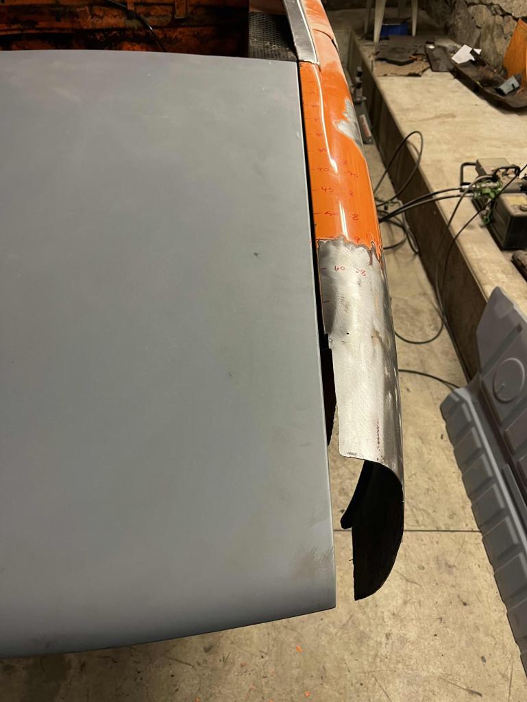

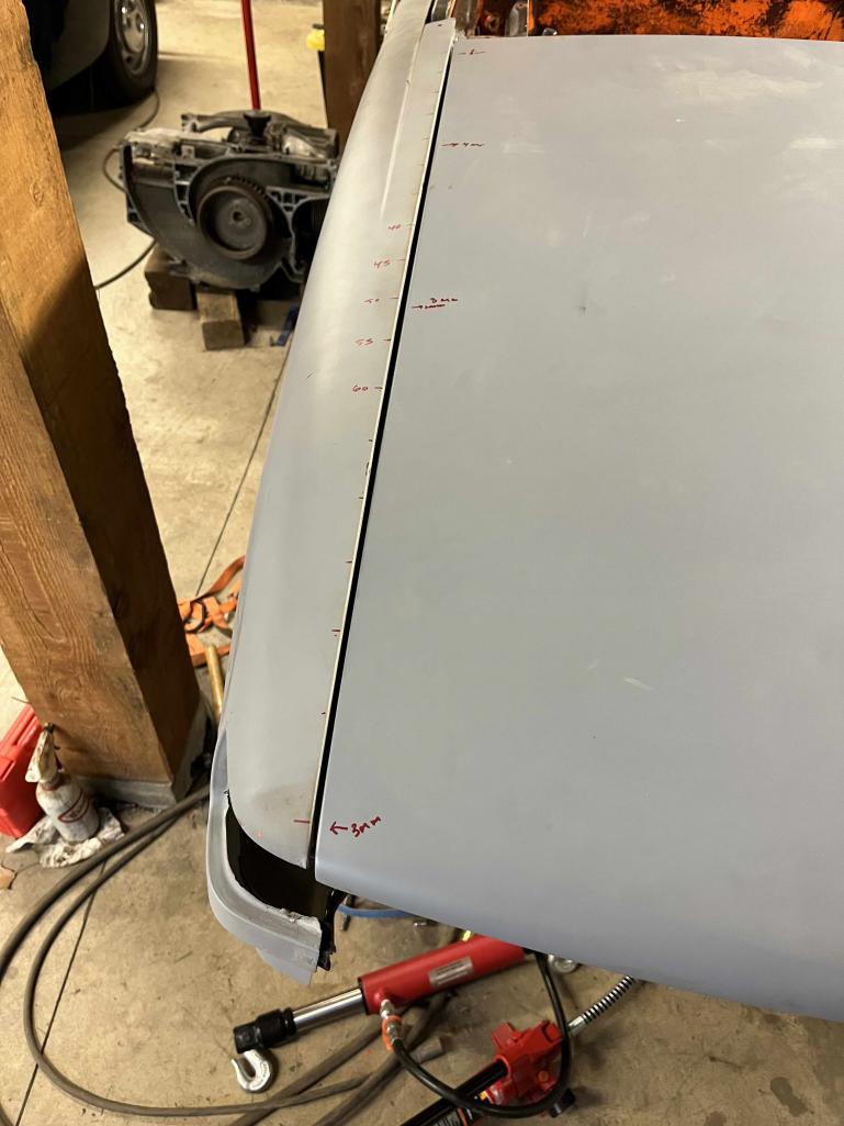

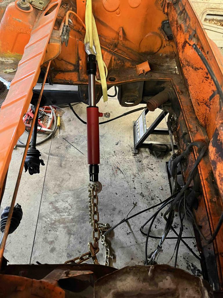

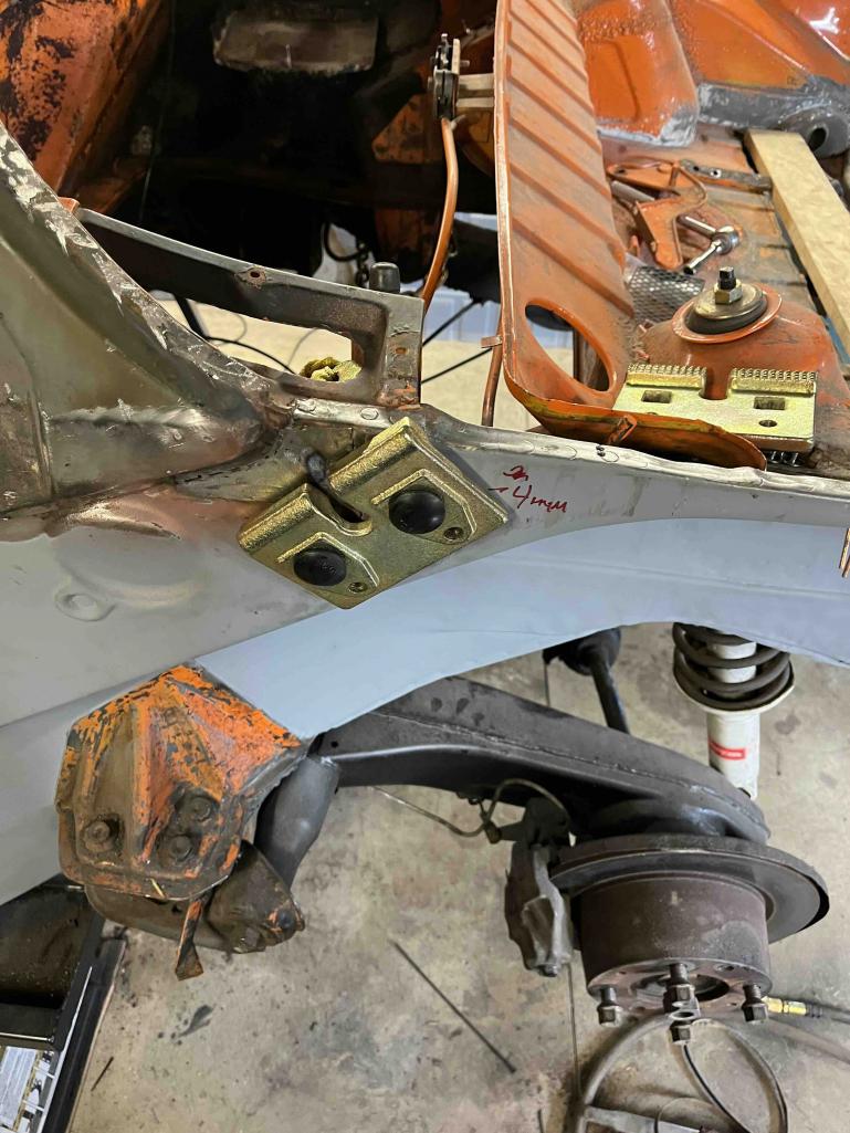

didenpx   Been plugging away at this consistently since the ...   Jan 3 2026, 07:11 PM
didenpx   Once I was confident that things were lining up pr...   Jan 3 2026, 07:26 PM
didenpx   Next came final fitting and welding of the RD trun...   Jan 3 2026, 07:33 PM
didenpx   Next came the butt welding of the rear trunk floor...   Jan 3 2026, 07:50 PM
didenpx   After I add material and grind the trunk lid gaps ...   Jan 3 2026, 07:53 PM
