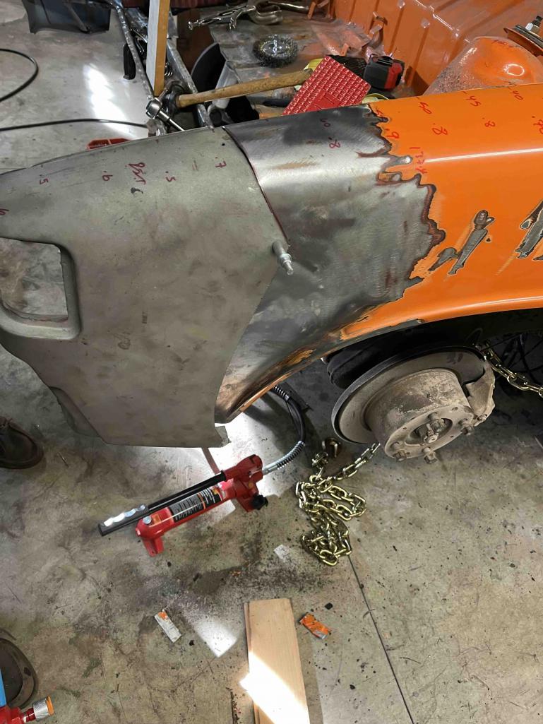

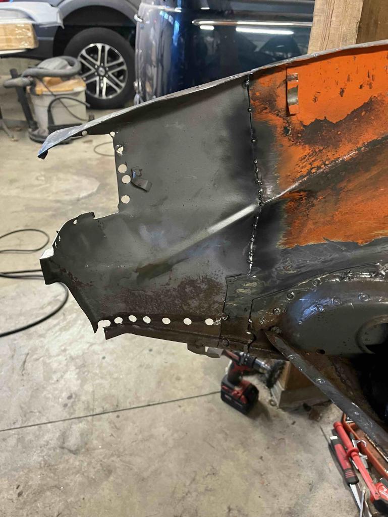

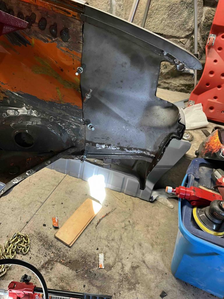

didenpx   Finally have made some progress in piecing togethe...   Oct 2 2025, 05:11 PM

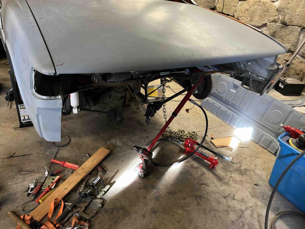

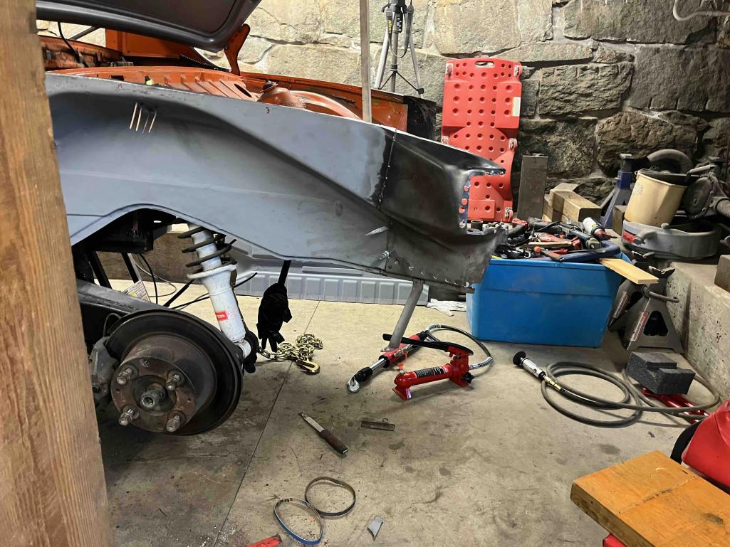

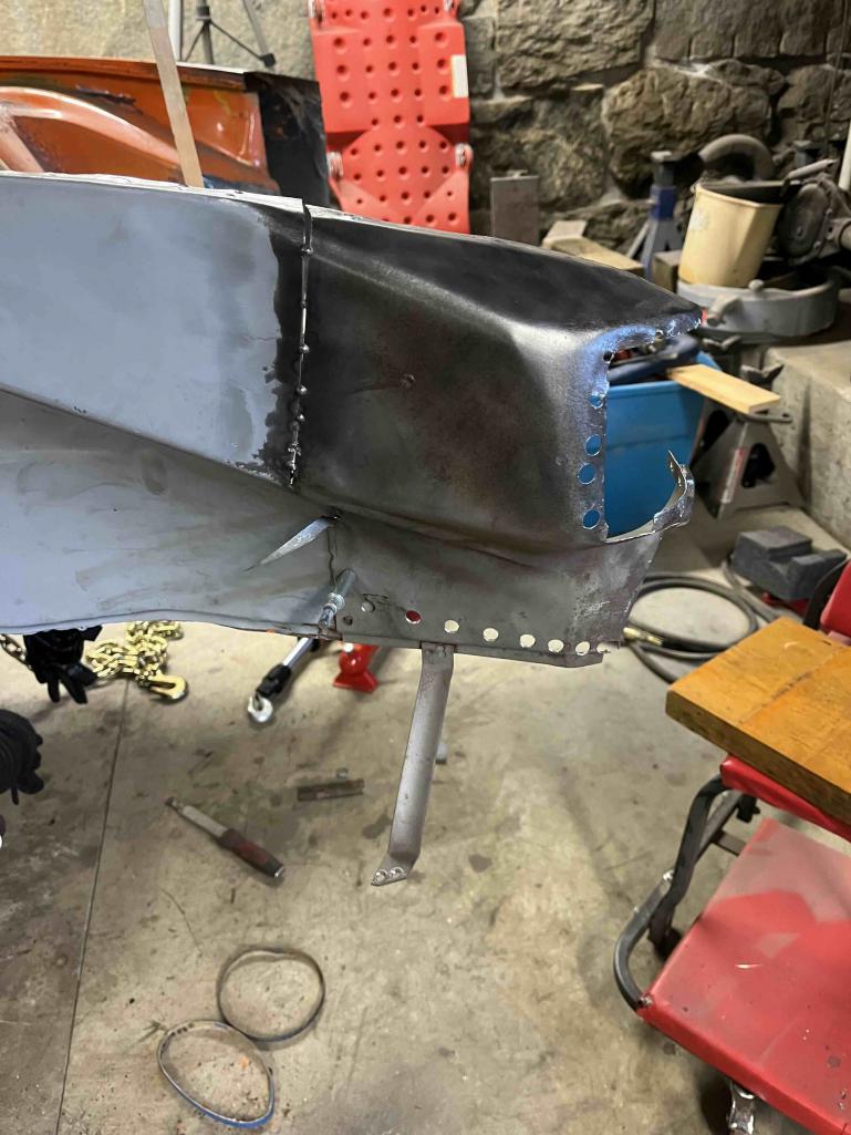

didenpx   Good progress this week. The quarter patches are ...   Oct 18 2025, 09:20 AM
