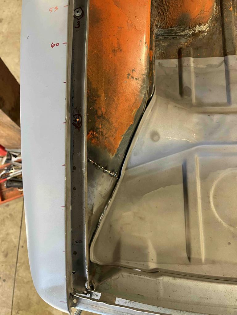

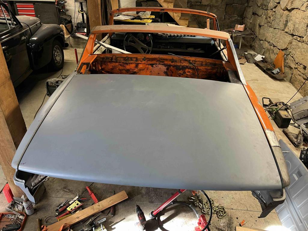

Photos below tell the story but the worst of the rust appears to be in the aft section of the LH outer longitudinal. I haven’t pulled the battery and ECU out yet, but from what I can see underneath the car, inside the engine bay, and between the quarter panel and the engine compartment tin the hell hole appears solid (but I’m prepared to find surprises). The rear of the car seems worst off with rot from the foam above the tail lights partially cut out and partially corrected (I’ll be cutting that all back out and starting the job fresh). It was also hit from behind on the LH side and although I haven’t measured everything out yet, from what I can see underneath things don’t seem to be out of whack (maybe wishful thinking as the panel gaps for the rear trunk are uneven). The trunk lid itself somehow didn’t rust out along the rear edge, but it’s suffered a lot of abuse in the form of a now missing luggage rack and a black fiberglass spoiler that had been attached with wood screws. The front of the car doesn’t show any signs of impact damage but the trunk lid sits high when latched on the LH side.
My plans are to do a driver quality restoration (between a Hagerty 2 and 3) and get it on the road where I can enjoy it; I’ll cut out and weld the rusty sections, do as much of the body work myself as possible (thankfully it is very straight and the paint meter indicates there shouldn’t be a lot of bondo hiding under the old re-spray) and get a professional re-spray at a local body shop. I’ll either farm out or attempt to DIY the engine work myself. Since I’m assuming the engine will need a rebuild (see below) I’d definitely like to increase the displacement while staying with the stock FI setup.
