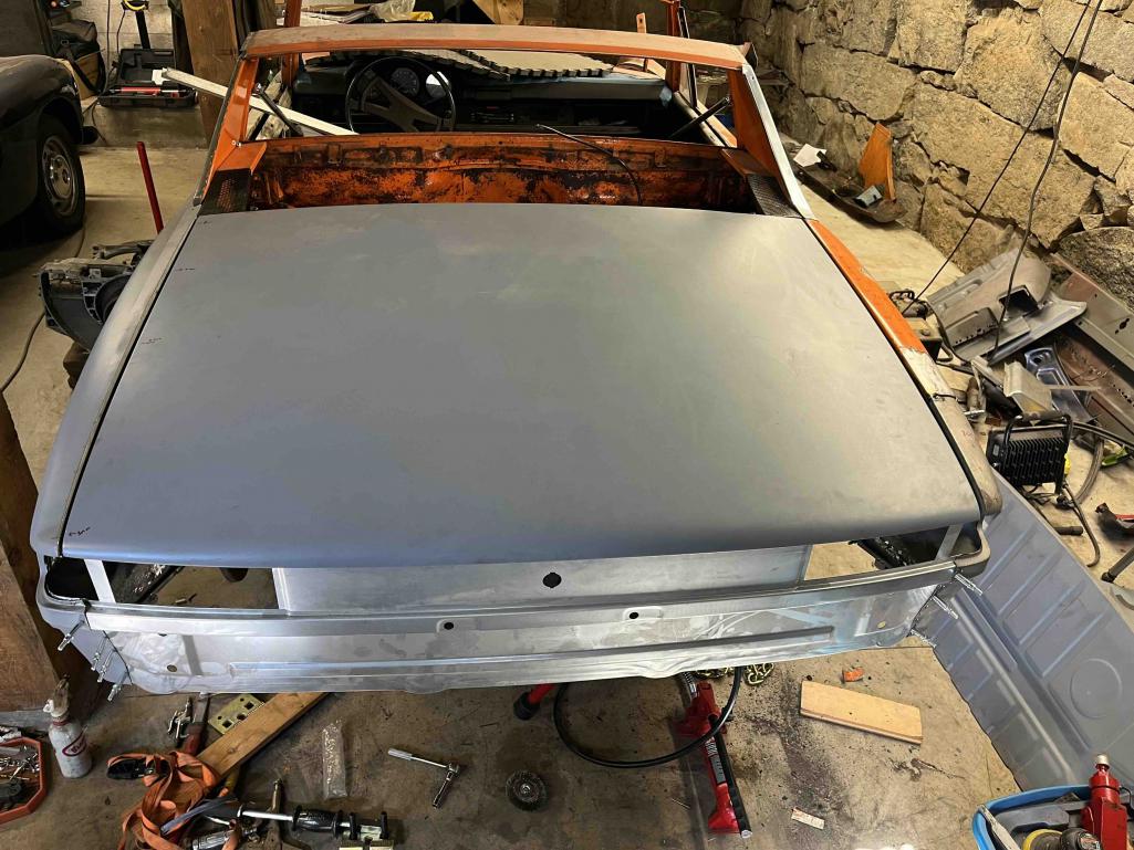

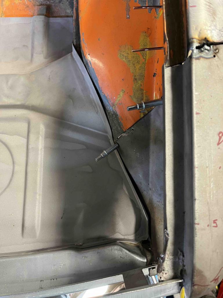

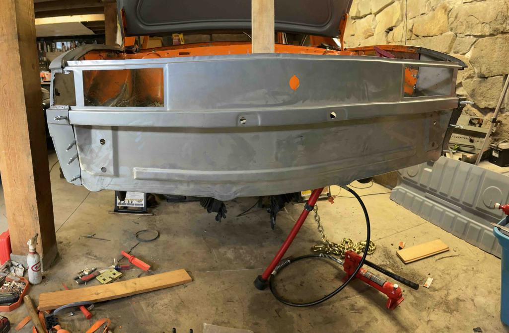

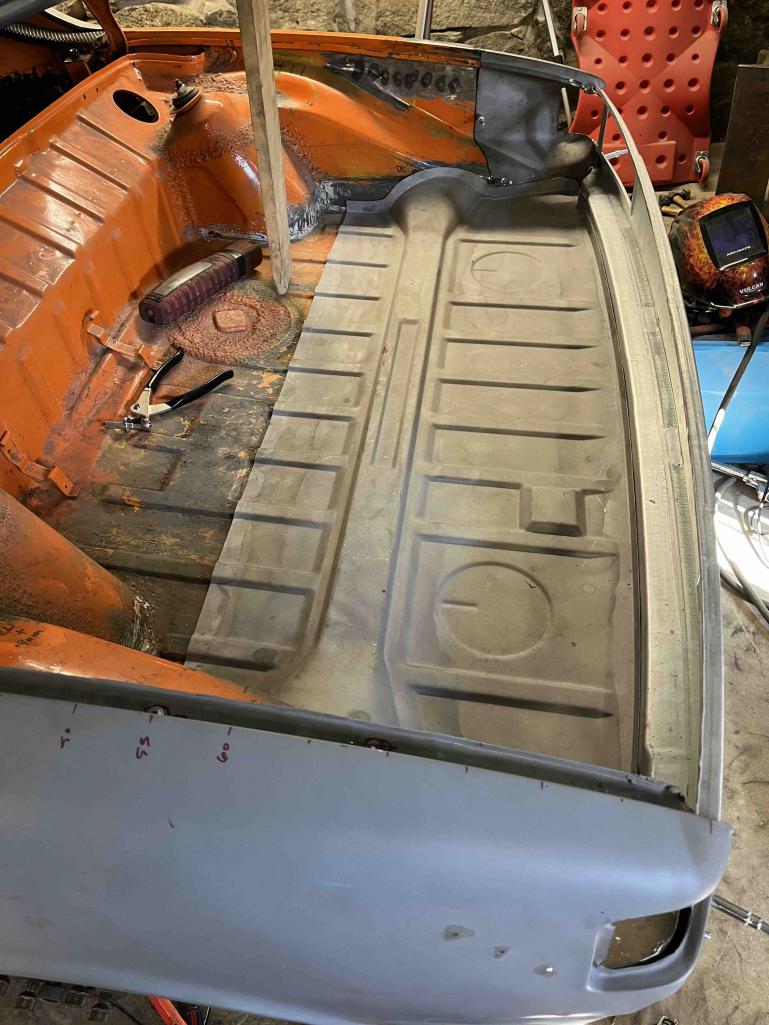

Got a couple more hours in today and was able to fit the rear valence (which required more tweaking of the fender gaps) and also loosely fit the trunk floor pan just to see how well it is lining up with the inner quarters and rear valence (pretty well!).
I'm using a diagram of average panel gaps that I found on a thread here somewhere and printed off; I'm not sure who produced it, but it is very handy. It also relieves a lot of stress over them not being perfect of exact...since they apparently never were to begin with.
Next week I will start welding in the RH rear quarter patch followed by the rear valence. Still lots of cleaning and prep work to do but at least I can see the light at the end of this particular tunnel!
