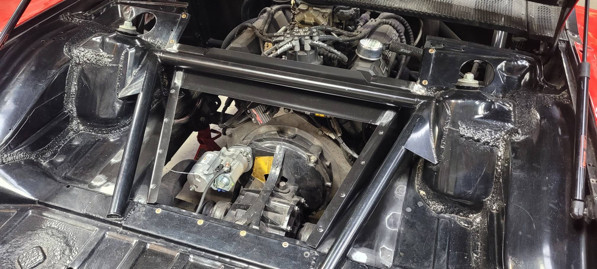

post Oct 14 2025, 06:57 AM
Posts: 5,784
Joined: 6-October 15
From: Petaluma, CA
Member No.: 19,241
The cross bar is in, the framework for the removable covers is in. Almost finished back here. Greg is doing a great job and I suspect we'll be partnering up on future projects, too.
And it turns out that VHT Epoxy Paint is a great match for years-old powder coat! (IMG:style_emoticons/default/aktion035.gif)
