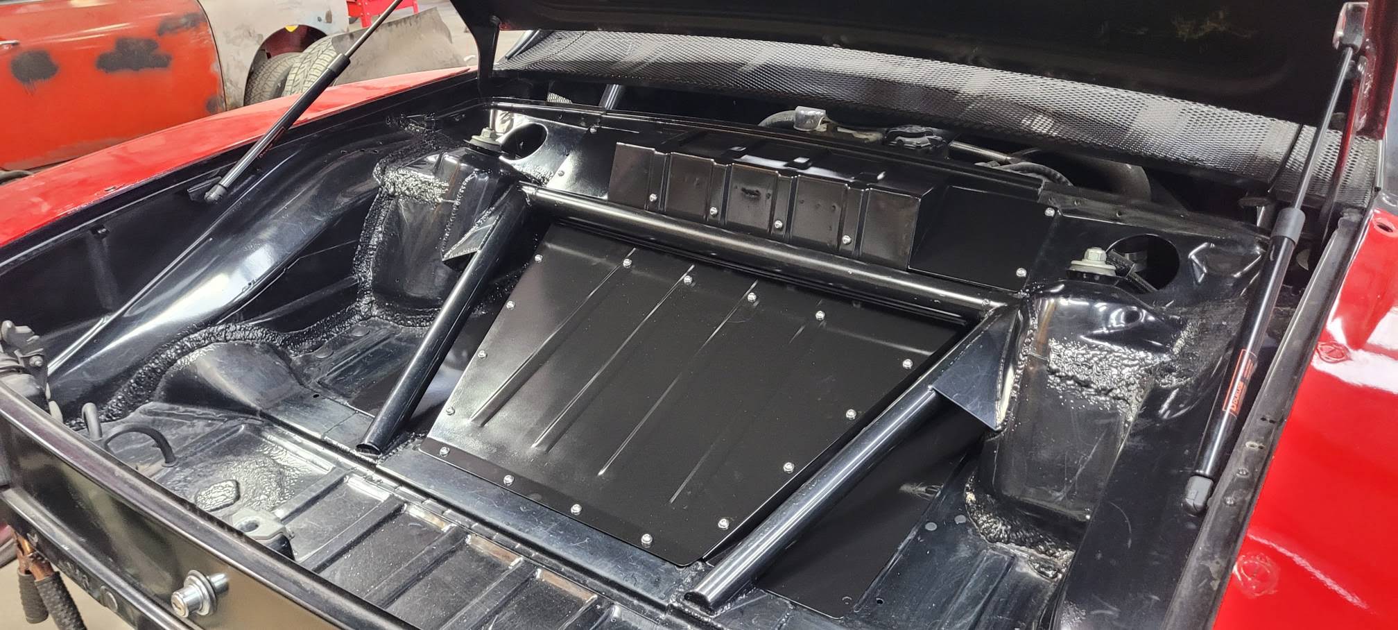

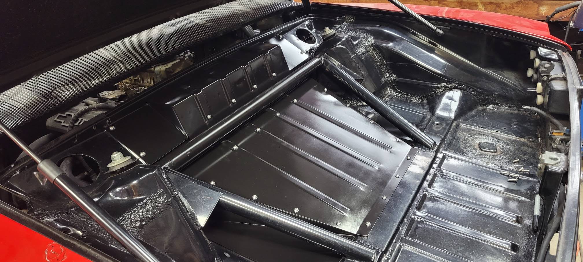

Two-piece removable engine / trans cover complete.
I think it's a nice match and fits the vibe of this build. And yes, the top still fits.
