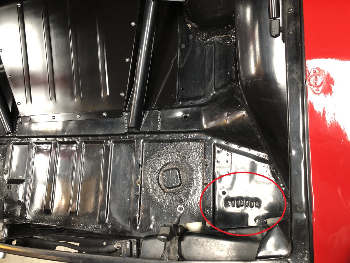

@T.Rick6 - the chassis # location in the right rear corner.

T.Rick6   Let's fix that hole in the rear of the trunk....   Oct 14 2025, 12:07 PM
tygaboy   Let's fix that hole in the rear of the trunk...   Oct 14 2025, 05:16 PM

Cairo94507   Are you asking about the chassis number? That is ...   Oct 14 2025, 05:19 PM
tygaboy   Are you asking about the chassis number? That is...   Oct 14 2025, 06:37 PM
davep   The Karmann body (Chassis) number Was stamped into...   Oct 15 2025, 12:06 PM
tygaboy   The Karmann body (Chassis) number Was stamped int...   Oct 15 2025, 12:42 PM
barefoot   The Karmann body (Chassis) number Was stamped int...   Dec 5 2025, 08:52 AM
davep   I was one of the first to figure out the Karmann b...   Oct 15 2025, 02:18 PM

tygaboy   @T.Rick6 - the chassis # location in the right re...   Oct 17 2025, 09:56 AM
T.Rick6   [b]@[url=http://www.914world.com/bbs2/index.php?s...   Oct 17 2025, 11:37 AM
