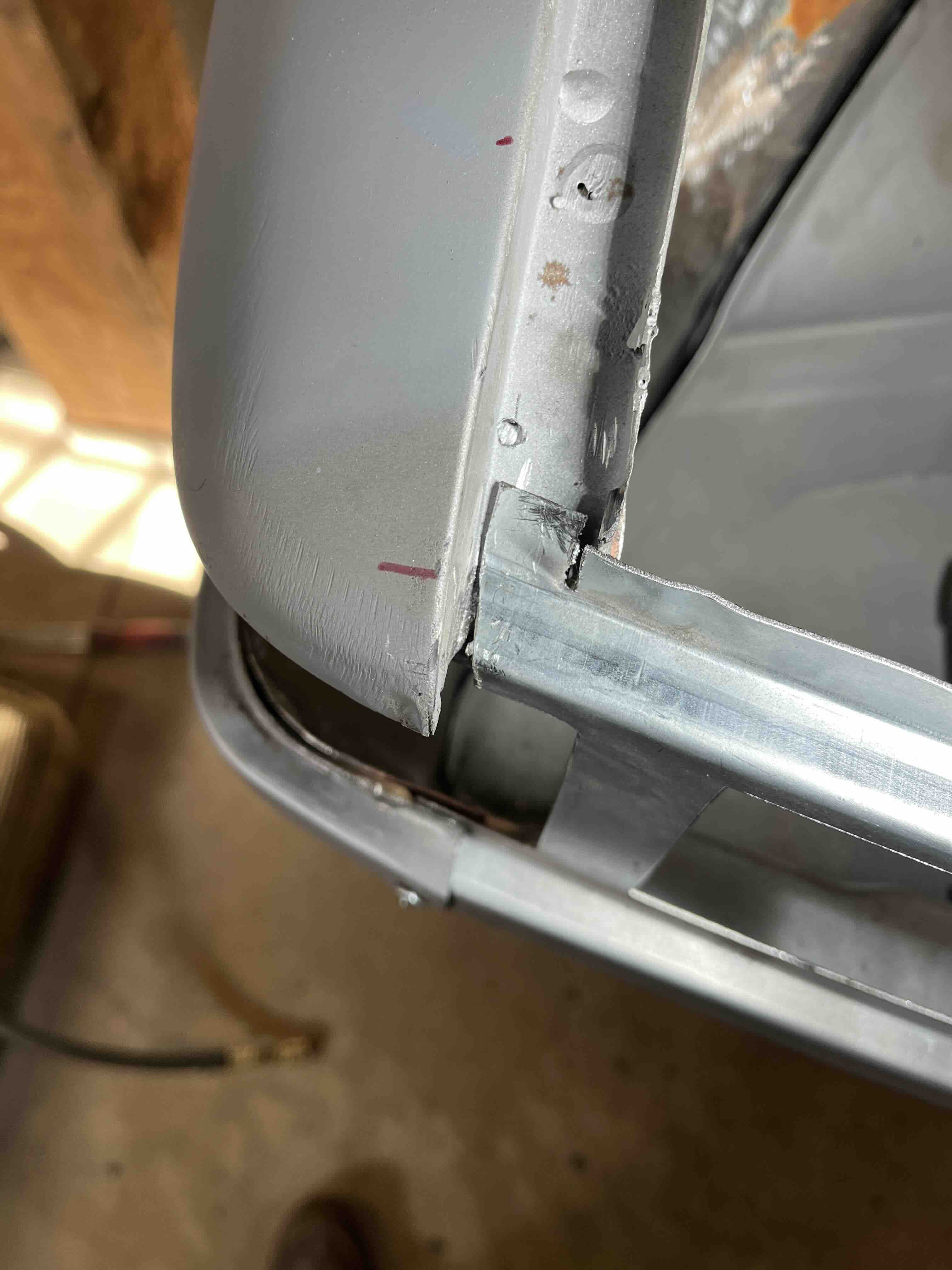

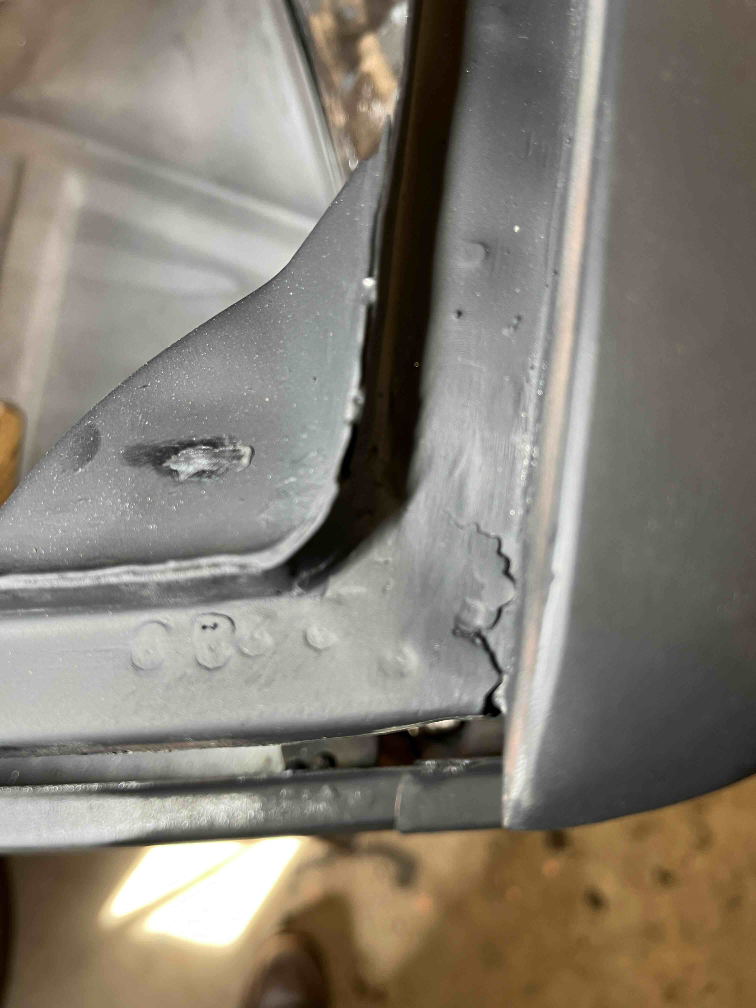

Paul, this has come a long way. You have some great skills!
Would you have any more pictures of where the top corner of the tail panel comes together with top rear corner of the fender/quarter?
I understand this to be a leaded joint from the factory so it gets smoothed out but I’m not clear on how the panels meet and connect.
Thanks in advance if you can.

Thanks @Seanpaulmc; not sure about the skill part. But lots of stubbornness and determination.
On the RD rear valence I made a relief cut on the top edge where it meets the weather stripping lip that forms part of the outer quarter. I then folded that down into the rain channel, spot welded it in place, and then welded the seam between that tab and the rain channel best as I could. Before it goes into paint there will obviously be bondo to smooth the area out and I plan to slather body seam sealer on the underside of that area just in case any water finds its way in.
I also spot welded the rear valence where it meets the inner quarter; you can see that I still have some metal persuasion to do to get the inner quarter up a few mm on the LH side.
I'm not sure if this is how it was originally done but it seemed to make sense as things
came together.
Paul
