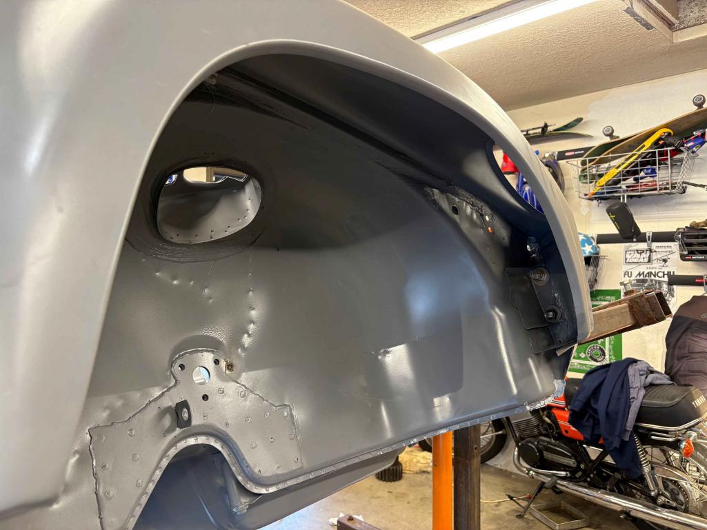

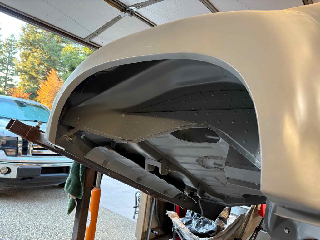

Hi all, its been a while.
Finally got to fix all the pinholes uncovered by the media blasting. Not a lot, just time consuming work making patch panels now getting the car prepared for undercoating.
I've decided on using RaptorLiner truck bed liner, then use a clear coat over it. However before I begin that, wondering what to do about the extra lip inside the steel fenders. My two options it seems are to either trim or to roll them.
Leaning towards the trim option but would like to see what others have done.
If I were to roll it, can you just do it cold? What are the techniques for rolling the fender lip?
Thanks,
-Glenn
