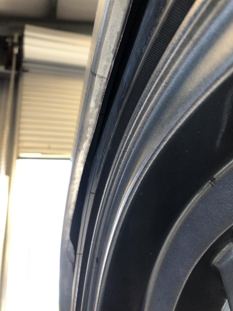

Have you fit your wheels and tires so you know what clearance you have or need?
I have 9" x 16" with a 13 offset so these sit 2 mm farther outboard than a 9" Fuchs and I opted to trim mine.
Not the greatest pic but you get the idea.
