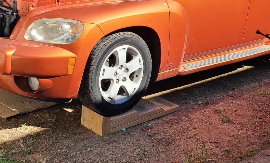

I made ramps out of 2x10's:

QUOTE(808 WRX @ Oct 24 2025, 09:26 AM) *
Exactly what I did. Gets the car up just high enough for me to get my fat head underneath along with the the oil catch container.
