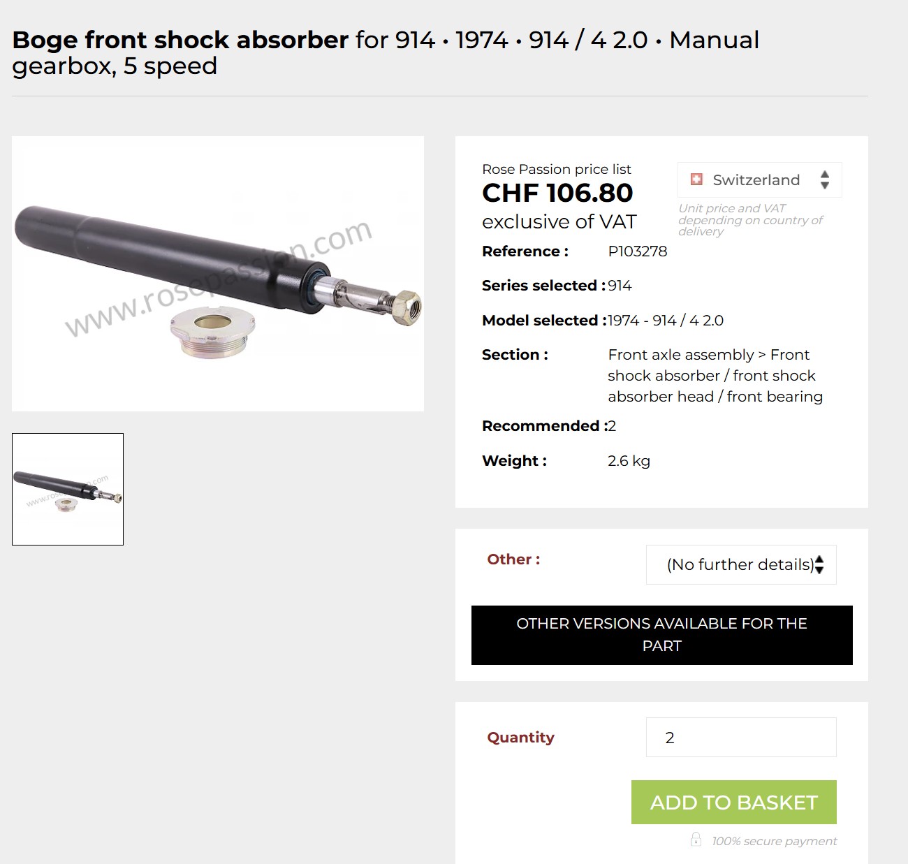

I'm tired of my bone-shaking Bilsteins... Really, really tired...
Late last year, had to replace a broken front Koni (that came with the car), my guy here suggested replacing both sides with Bilsteins and I said OK... There were already Bilsteins in the rear when I got the car. Me and everyone else who has ever ridden in this car agrees it's now way too stiff. I was looking around for alternatives and found this: https://www.rosepassion.com/en/diagrams-por...1-103278-z90088 Real Boge's?? Didn't know they were made anymore. Look reasonably inexpensive too... Unfortunately, the rears are listed as out of stock... https://www.rosepassion.com/en/diagrams-por...absorber-103279 I know AA has remanufactured both front and rear (further up in this thread). Shipping of a couple of rears to this side of the pond would be pretty expensive, and there is always the question if they even accept things with pressurized gas... @dr914@autoatlanta.com : you said above that they were manufactured in England... Any way to get them directly here in the "old world"? EDIT: just found there are also front and rear KYB units available here… worth a try? Also, I have no idea which springs/torsion bars are actually on the car. How to tell? TIA |

chmillman Back in here because the “Boge” front inserts ... Nov 7 2025, 03:02 AM
Back in here because the “Boge” front inserts... Nov 7 2025, 06:32 AM
