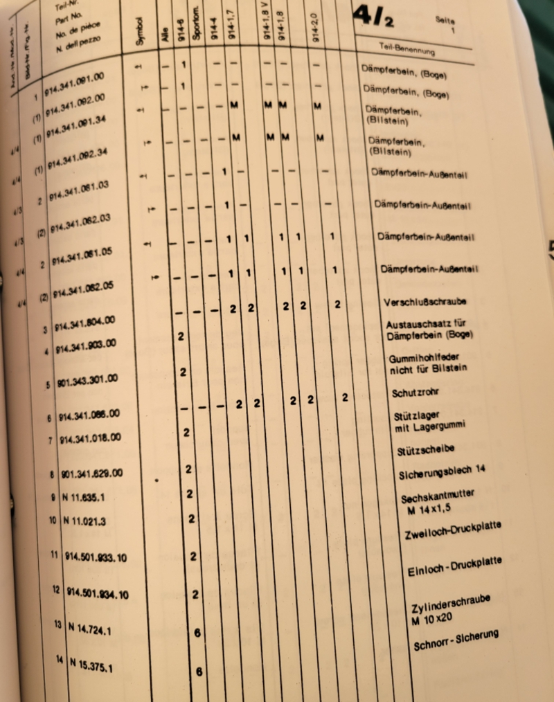

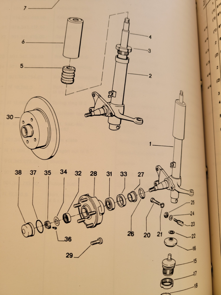

mepstein   Are the arms on the strut that secure the ball joi...   Nov 3 2025, 06:04 AM
wonkipop   @chmillman part numbers for front struts. yo...   Nov 3 2025, 11:14 AM
chmillman   your struts have correct numbers for a 74 Well...   Nov 3 2025, 11:55 AM
wonkipop   @chmillman interesting. i see what you are say...   Nov 3 2025, 03:22 PM

wonkipop   More :beer2: wow. excellent document. acco...   Nov 3 2025, 05:25 PM
chmillman   More :beer2: @sixnotfour - Wow, great info, th...   Nov 4 2025, 02:53 AM
wonkipop   had another good look at mine. definitely a 4. st...   Nov 3 2025, 05:07 PM
wonkipop   i'm seeing something else interesting there to...   Nov 3 2025, 05:35 PM
sixnotfour   BOGE manufacturer number ? Looks like it in thi...   Nov 3 2025, 05:36 PM
wonkipop   BOGE manufacturer number ? Looks like it in th...   Nov 3 2025, 06:07 PM

sixnotfour   OG BOGE ,,not exactly an insert..The strut housin...   Nov 3 2025, 07:11 PM
