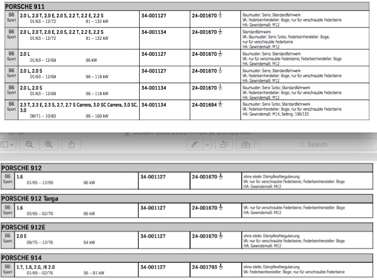

had another good look at mine.
definitely a 4. straight steering arm i believe as per eric shea's very detailed description.
(not a bad thread topic that one! - very good read).
didn't /6s have a wider track at the front as well?
cannot see anything engraved or marked into it like yours.
just a white date stamp.
given the rest of the description e shea lists out yours must be running 5 stud conversion? - done proper? with /6 hubs? and real 6 struts with bent steering arm? arm is to do with the track width.
despite detail at lower end of the strut - the B6s definitely go in either version.
4 or 6. page from bilstein classic catalogue.
and i already know b6 inserts go straight into /4 struts that were equipped with boges.
so it works the other way around as well. boges can go straight into whatever was taking the B6. because some /6s were equipped with boges i believe or they were the standard shock in the 6 just like the 4.
34 as first bit of part number in catalogue means insert.
35 would be indicating a whole strut assembly.
which i do think bilstein make still today and offer.
but it sounds like there is a trick to those full strut assemblies between a 4 and a 6! (IMG:style_emoticons/default/biggrin.gif)
