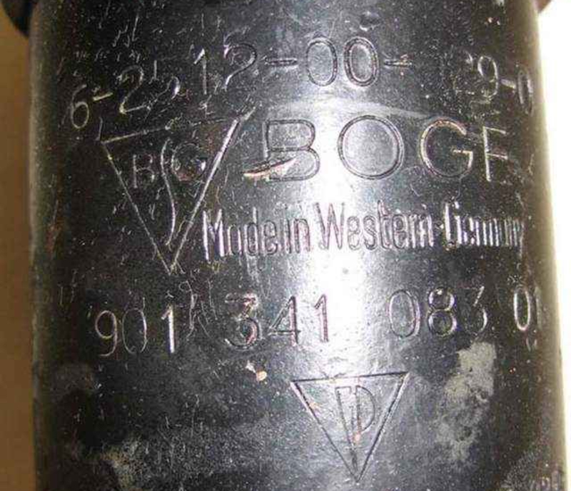

i am guessing the top number 1 0221 32 090 0/091 0 is a bilstein part number?
BOGE manufacturer number ?
Looks like it in this pic....

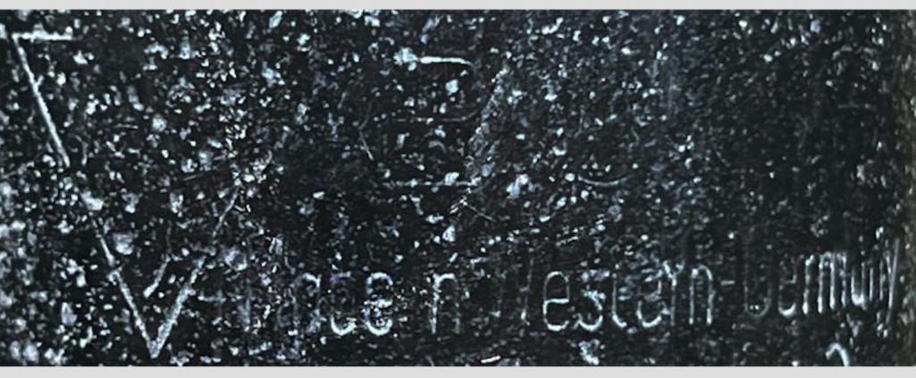

QUOTE(sixnotfour @ Nov 3 2025, 05:36 PM) *
EDIT
matches chmillmans when you blow up his photo for markings.
can just see boge and the big triangle is the boge trademark.
all a bit faint and barely there on his.
