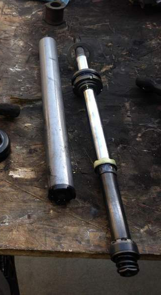

An insert for 275? What and why? Is it just rarity? Some strange one off design that no other car uses?

OG BOGE ,,not exactly an insert..The strut housing was a fluid reservoir.

dr914@autoatlanta.com   we had the original boges duplicated by a suspensi...   Jun 7 2025, 09:17 AM
Superhawk996   we had the original boges duplicated by a suspens...   Jun 7 2025, 09:42 AM

914Sixer   Rebuilt shocks seem to be a thing of the past. I a...   Jun 7 2025, 05:35 AM

Superhawk996   Yup a terrible shame there aren’t Monro-matic or...   Jun 7 2025, 07:51 AM
