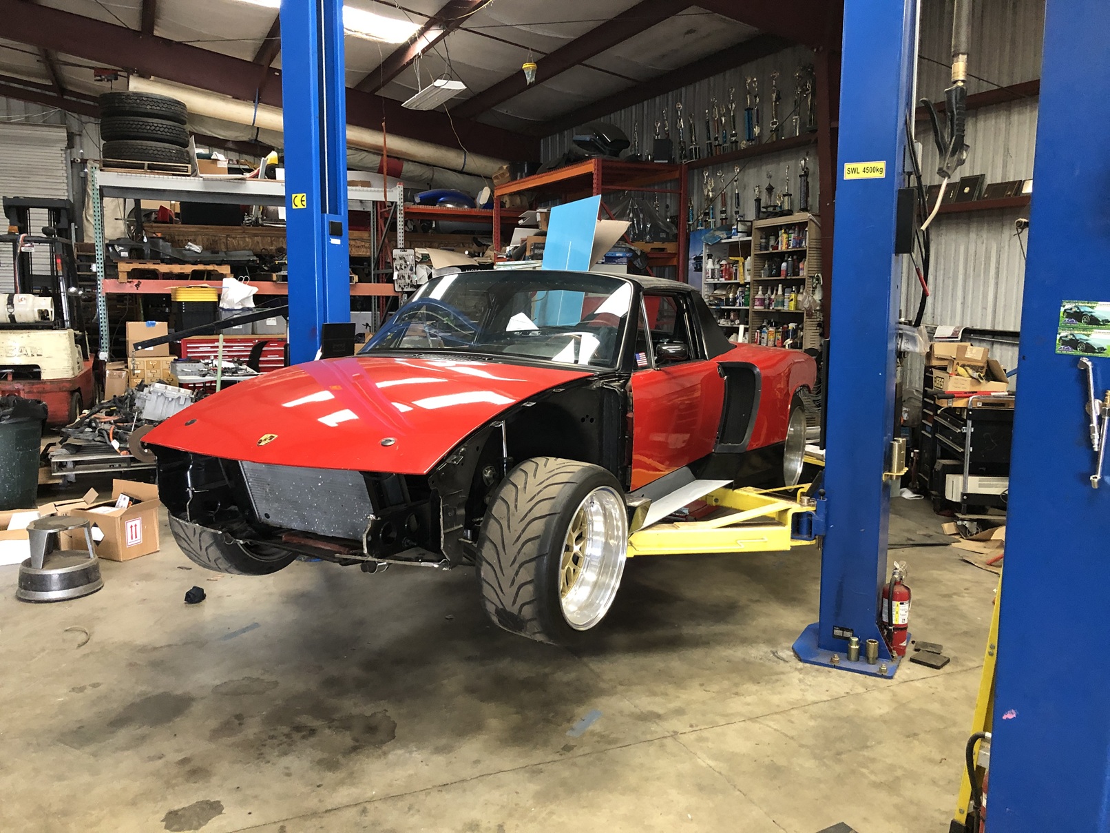

On to the chassis repairs! First, let's get it on the lift and start taking a closer look.
(Dang, those are some wide wheels/tires...)

tygaboy   On to the chassis repairs! First, let's ge...   Nov 6 2025, 07:00 PM
tygaboy   And the hits just keep on coming. The driver side ...   Nov 6 2025, 07:09 PM
