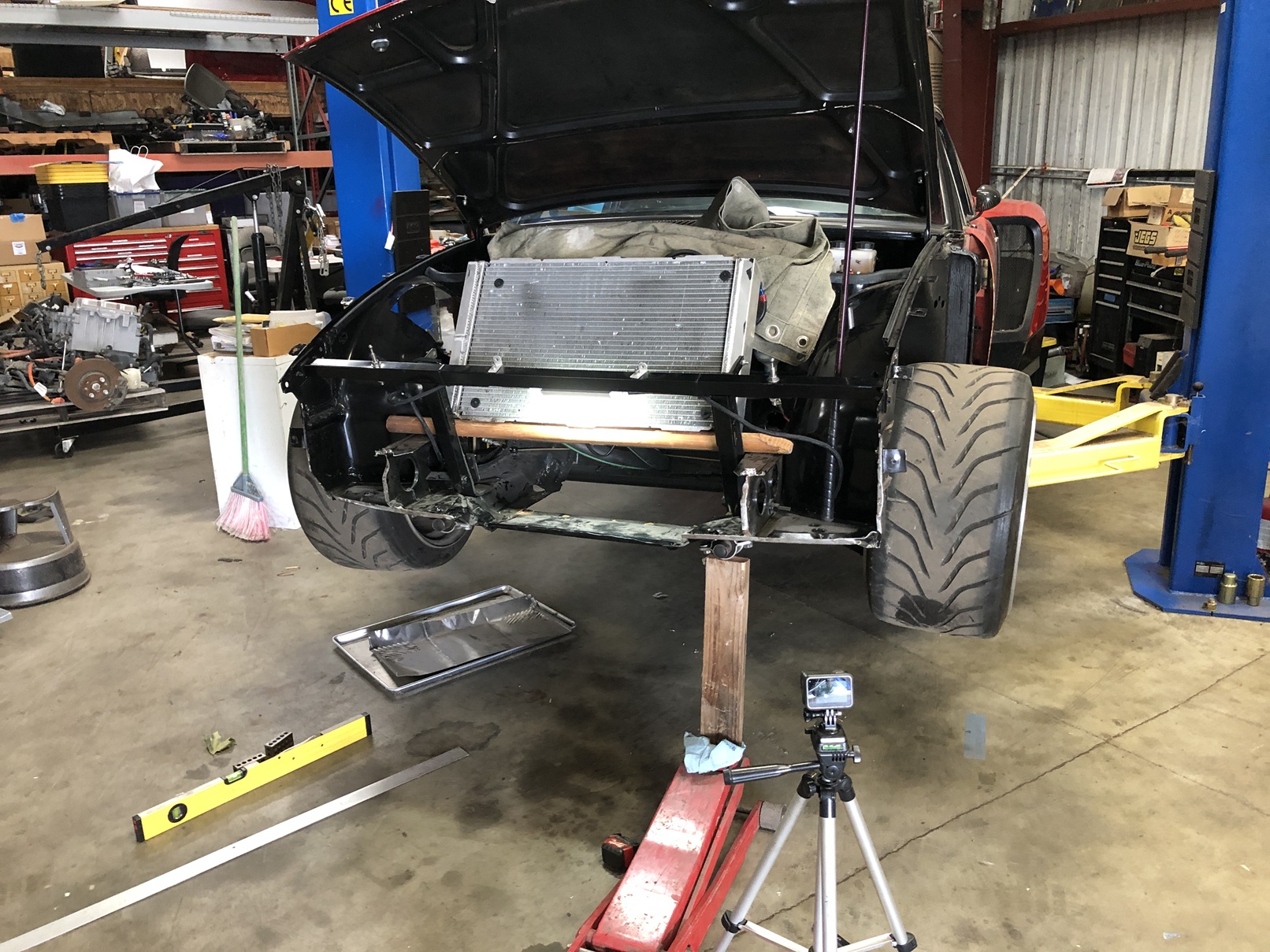

And the hits just keep on coming. The driver side front A-arm mount is a touch lower than the passenger side (or is the passenger side too high?). Not a lot, but it was obvious when you looked closely. A quick level check vs. the main front suspension cross bar and yep, it ain't right - not surprising given all the structure that's been removed.
Also not surprising is how easily this non OSHA-approved "adjustment rig" pushed the "low side" up. Still some analysis left to do before we commit to a solution.
But once the frunk floor and nose are back in (along with a pair of 1.5" tube struts from the shock towers to just above the front A-arm mounting location) this chassis will be back to what it needs to be.
And yes, it'll all be covered in an upcoming episode so stay tuned for all the details.
