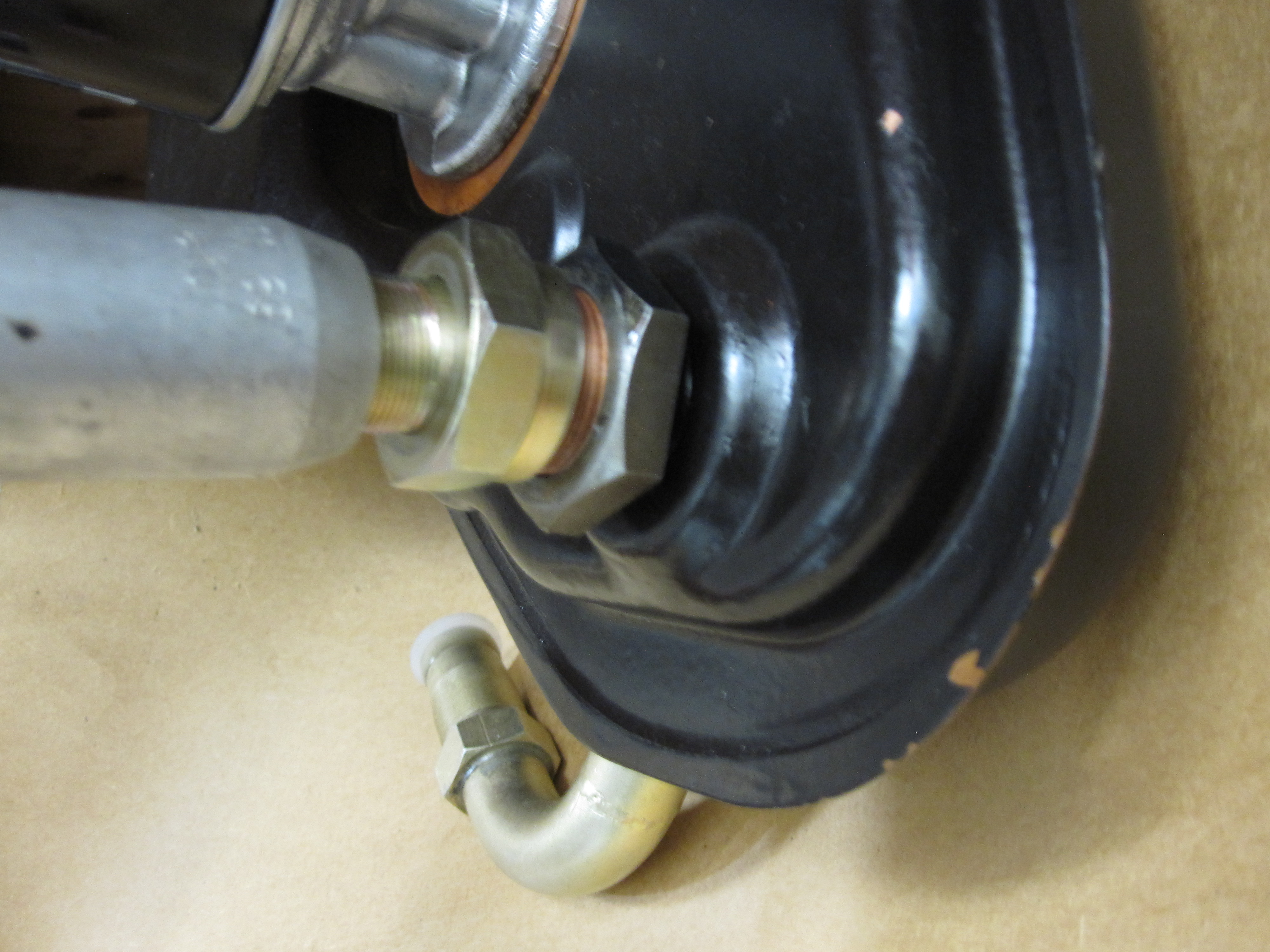

rgalla9146   Pic of third attachment point. 36 mm nut   Nov 11 2025, 12:55 PM
rgalla9146   Diagram of parts. #78 is a washer #79 is the ...   Nov 11 2025, 12:56 PM
IronHillRestorations   @colingreene PM sent AFAIK the large 36mm nut t...   Nov 12 2025, 07:29 AM
