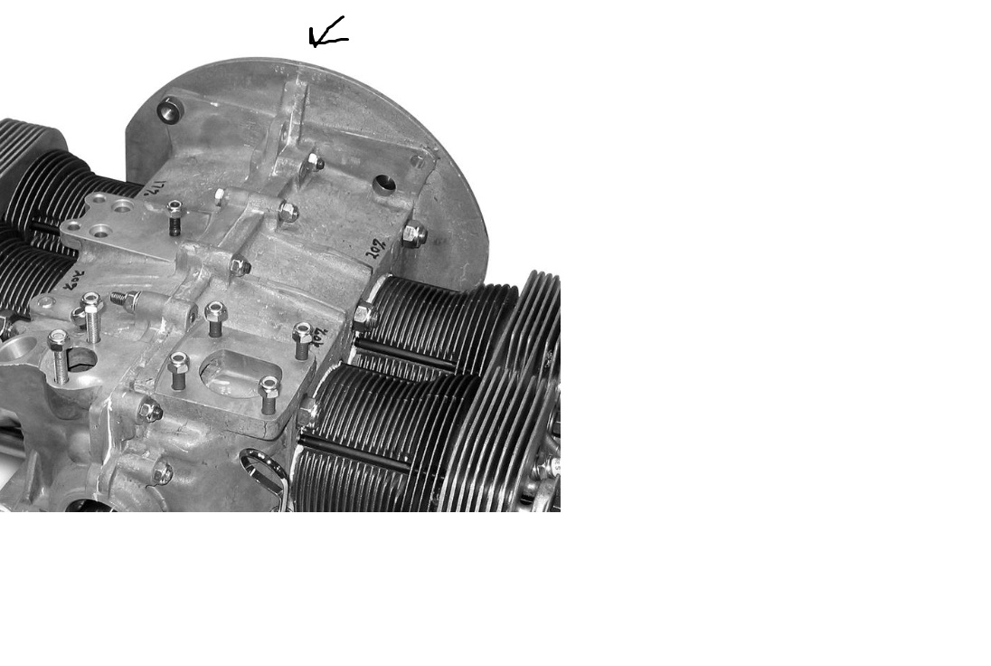

That area right there is where you want to look for your flywheel. Back of the engine compartment right between the tin and the engine. Use the case seam to line up the mark on the fly wheel. The mark on the flywheel is a rather good size divot. Hard to miss.
I wouldn't go digging in the valve covers. You can check to see if your rotor is pointing at the #1 spark plug wire if you need to. You could start there as well. Roll the car till the rotor is pointing near the #1 wire position (pointing towards the drivers seat) and then go look for the mark on the flywheel, then check to see if the piston is at TDC, then check the fan. All should line up.
