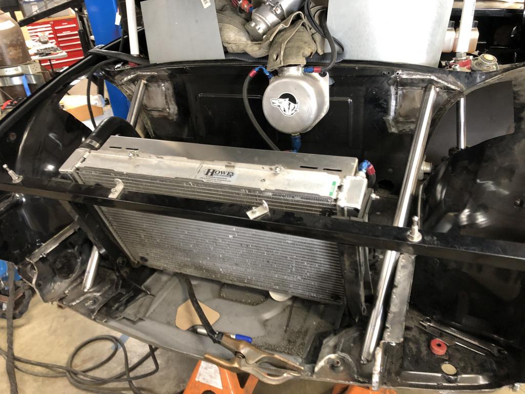

After measuring and correcting the location of the front A-arm mount locations, the support struts are in (about to be final welded) and the front end is stabilzed! And what a difference it makes. If you want to see just how much this chassis flexed before this fix, don't miss the next video.

tygaboy   On to the chassis repairs! First, let's ge...   Nov 6 2025, 07:00 PM
tygaboy   And the hits just keep on coming. The driver side ...   Nov 6 2025, 07:09 PM
tygaboy   Spoiler Alert about the coming episode: After meas...   Nov 19 2025, 04:04 PM

tygaboy   Transformation complete! The struts are wrappe...   Dec 1 2025, 05:09 PM

tygaboy   Front of car all mo' betta! Next, we start...   Dec 6 2025, 08:34 AM
