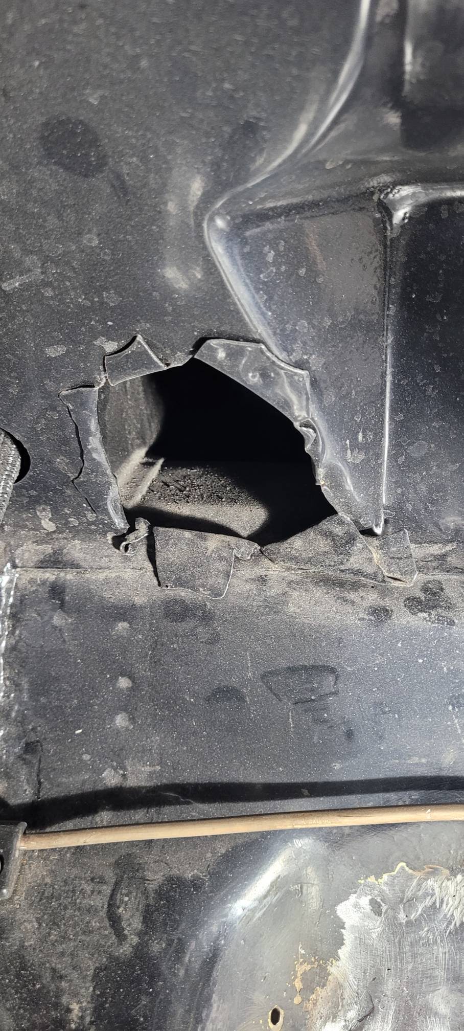

Those who have been following from the beginning know that I started out trying to be as kind as possible to the previous builder(s) as I don't have the entire story about why a particular thing was/wasn't done a particular way. Well, I'm over that!
Here, at the base of the fuel tank fire wall, passenger side, is the latest "Wall of Shame" find:
I mean, you go to the trouble of, let's call it "clearancing", (with a can opener??) hammer the excess material flat THEN paint over it?!?!?!
WTF.
Yes, we'll tidy it up as best we can.

QUOTE(tygaboy @ Dec 2 2025, 11:29 AM) *
WTF.
1. Many don't have the tools or knowledge to do it "right"
2. Some don't have the patience to do it "right"
3. By bending the edges over, they actually (slightly) strengthened and prevented a sharp surface from cutting whatever went through the opening.
Yes this is ugly, but not as ugly as the other atrocities committed on this car.

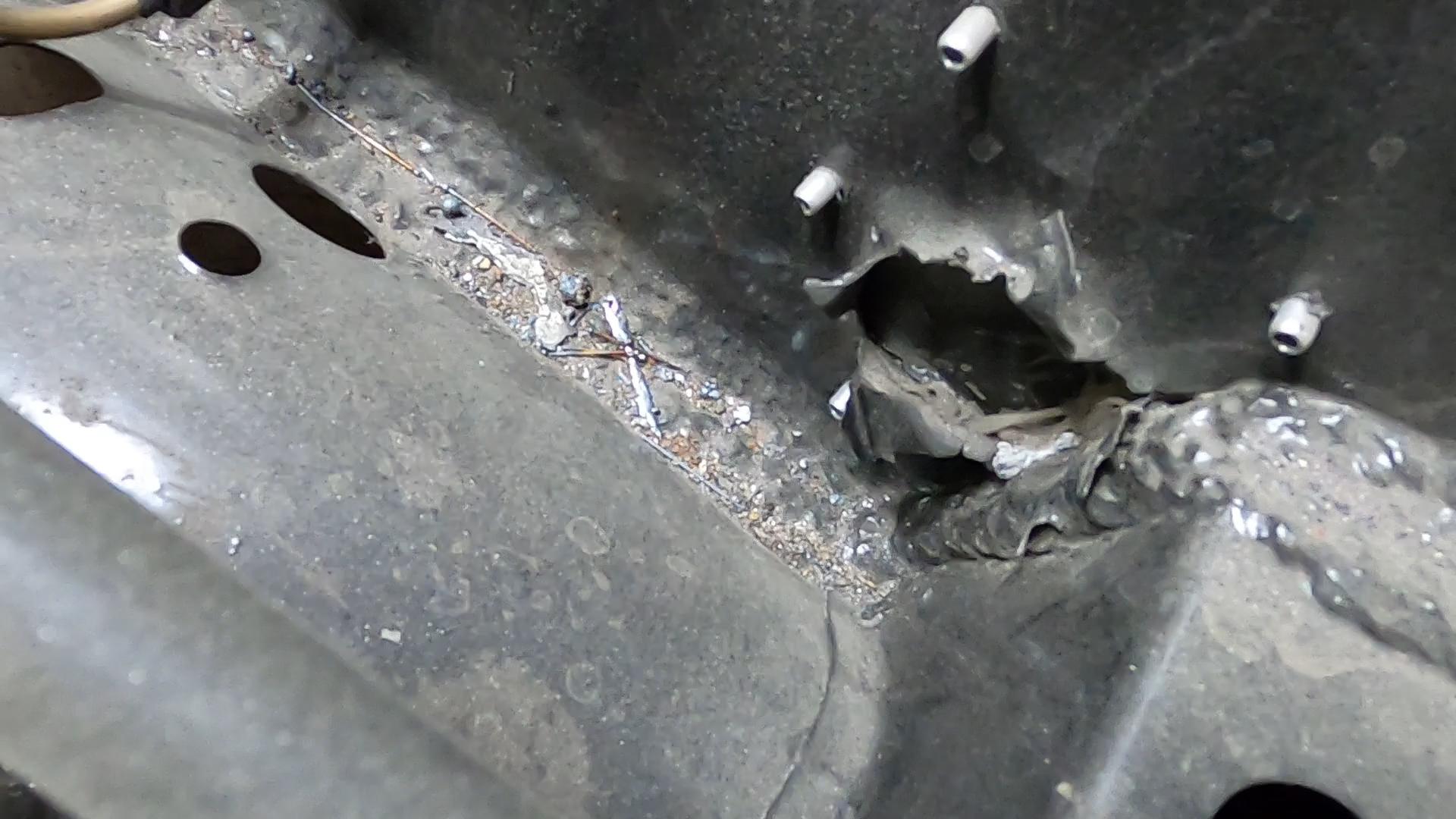

@tomeric914 - You mean like this one under the fuel tank? Spoiler alert that I mention this in an upcoming episode as looking like they used C4 to make the hole. I guess they took the time to "dress up" the one that could be seen?
I mean there's hack and then there's being a complete f-ing idiot... (IMG:style_emoticons/default/chair.gif)

QUOTE(tygaboy @ Dec 4 2025, 04:40 PM) *
Good God.
C4 or an air chisel. I mean, when all else fails, always look cool.
Maybe AI told them to do it that way... (lol, yes I know AI wasn't around when this was originally built, but the shoe kinda fits)
