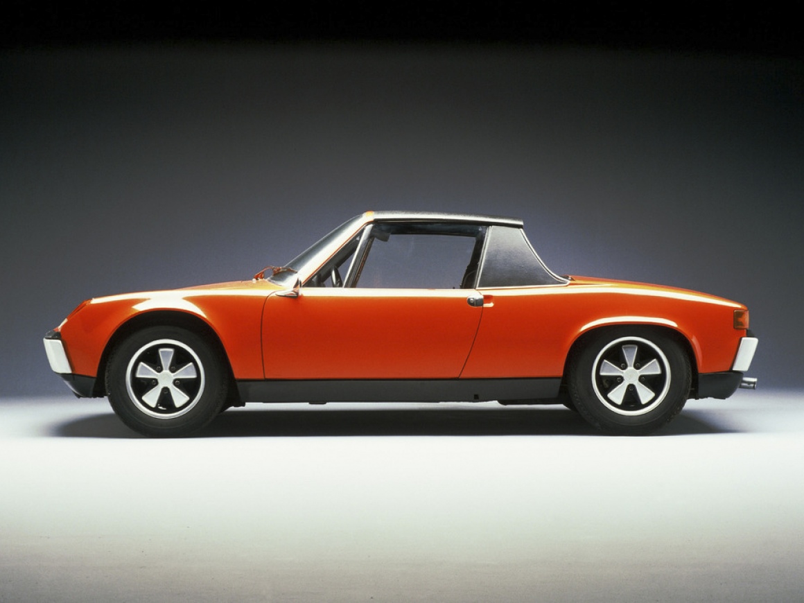

I am currently looking into getting a windscreen (as the UK or parts catalogs calls it) but I am only interested in one that would have the original shape (rounded top).
I saw a few restored 914-6 on display at Rennsport VII with the OE windscreen shape and they were Pilkington, not Sigla. I wasn't able to confirm if Pilkington is the new supplier of Porsche 914 windscreen replacement part, but I have a strong feeling it is.
These OEM windscreens are available in clear or tinted per these two part numbers.
Clear: 914-541-101-10
Tinted: 914-541-102-10
By tinted, I am not sure if they mean with a dark shaded band at the top or overall tint like the side glass (Delodur-1 and Delodur-F, -1 clear and -F tinted).
If someone has this information, please comment. (IMG:style_emoticons/default/smilie_pokal.gif)
My car has the Delodur-F (tinted) side windows and I would like to get the correct windscreen for it. That being said, I am not interested in having any dark shaded green band at the top, I would prefer clear, hence the question above.
For those who aren't familiar with what I am referring to as the shape, I found these two pictures trying to show it. The orange car (Porsche's 914-8) obviously has the genuine windscreen while the red car has a generic replacement. You can see how the top part of the windscreen is "bubbled up" creating a nice flowing live vs a sharp transition.
