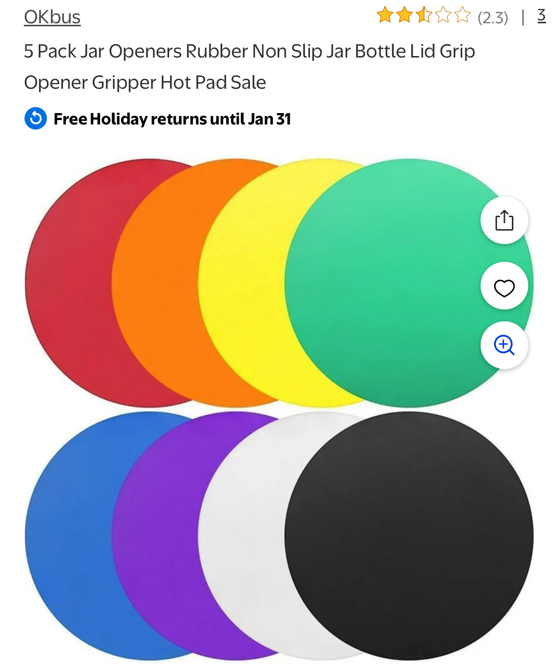

Some of them go on pretty tight and one of the round rubber lid removers will help.
Attached thumbnail(s) |
