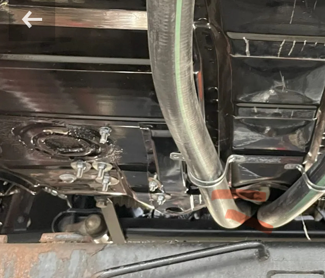

Front of car all mo' betta! Next, we start looking in on the mechanical stuff. Place your bets now: Will we find any more surprises? (IMG:style_emoticons/default/idea.gif)
https://www.youtube.com/watch?v=WScgxNRMH7E
