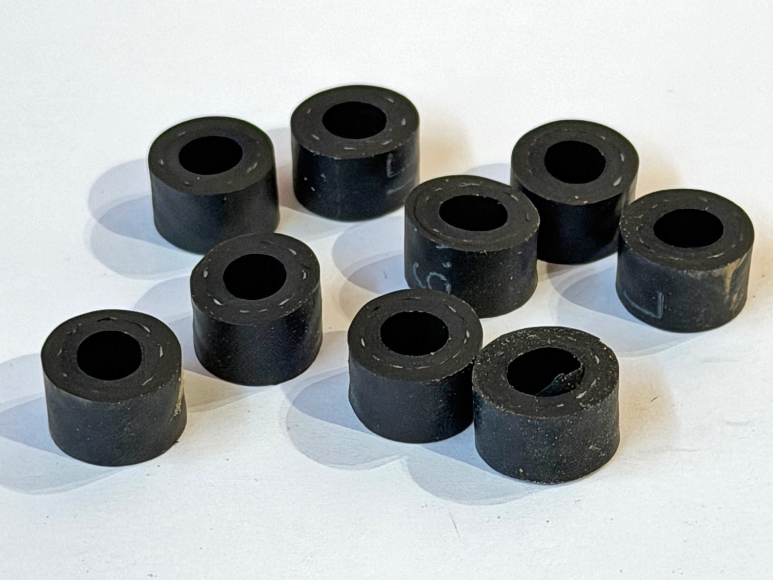

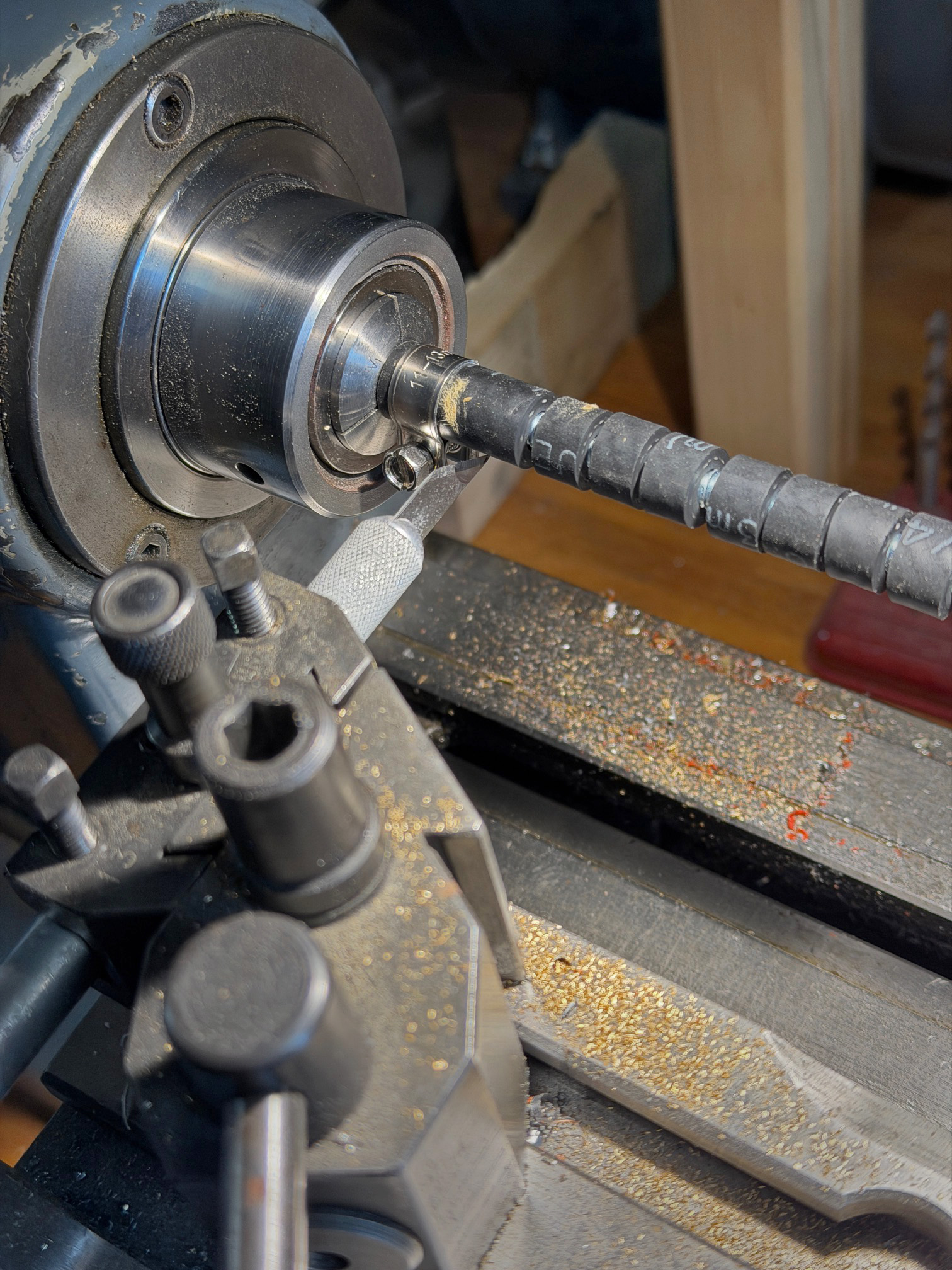

So I went the sliced fuel hose route for now, until I can find something better.
They aren't absolutely perfectly even - they would have been if the bit of hose I had was straight, but unfortunately it had a slight bend to it - but they're rubber and will compress anyway. 6mm ID, 13mm OD. I went with a 7.5mm target height. It was a $0, right-now solution which seems to work fine. |

So I went the sliced fuel hose route for now, until I can find something better. They aren't absolutely perfectly even - they would have been if the bit of hose I had was straight, but unfortunately it had a slight bend to it - but they're rubber and will compress anyway. 6mm ID, 13mm OD. I went with a 7.5mm target height. It was a $0, right-now solution which seems to work fine. I really love the da to knife clamped into the tool holder. |
