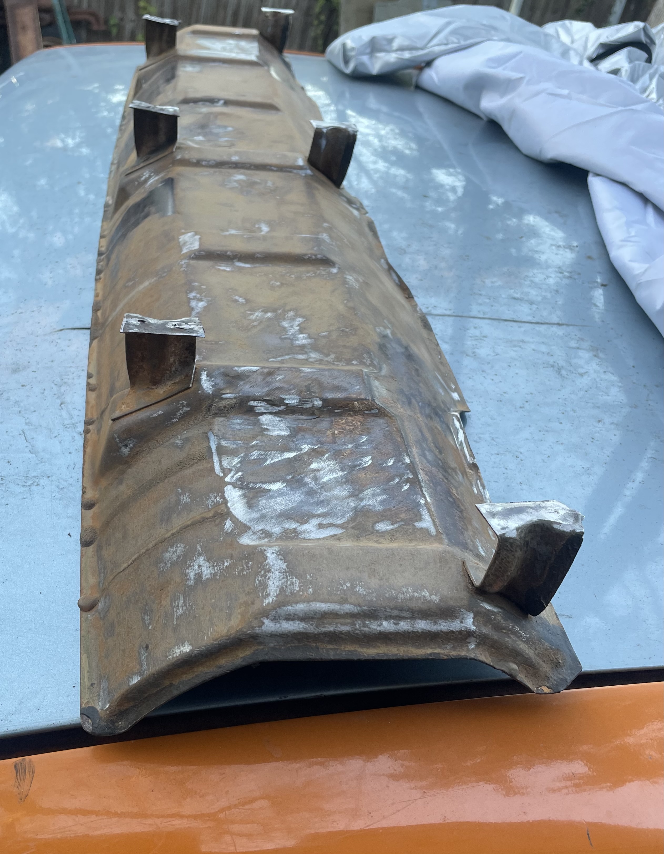

I then salvaged the original heat shield:
