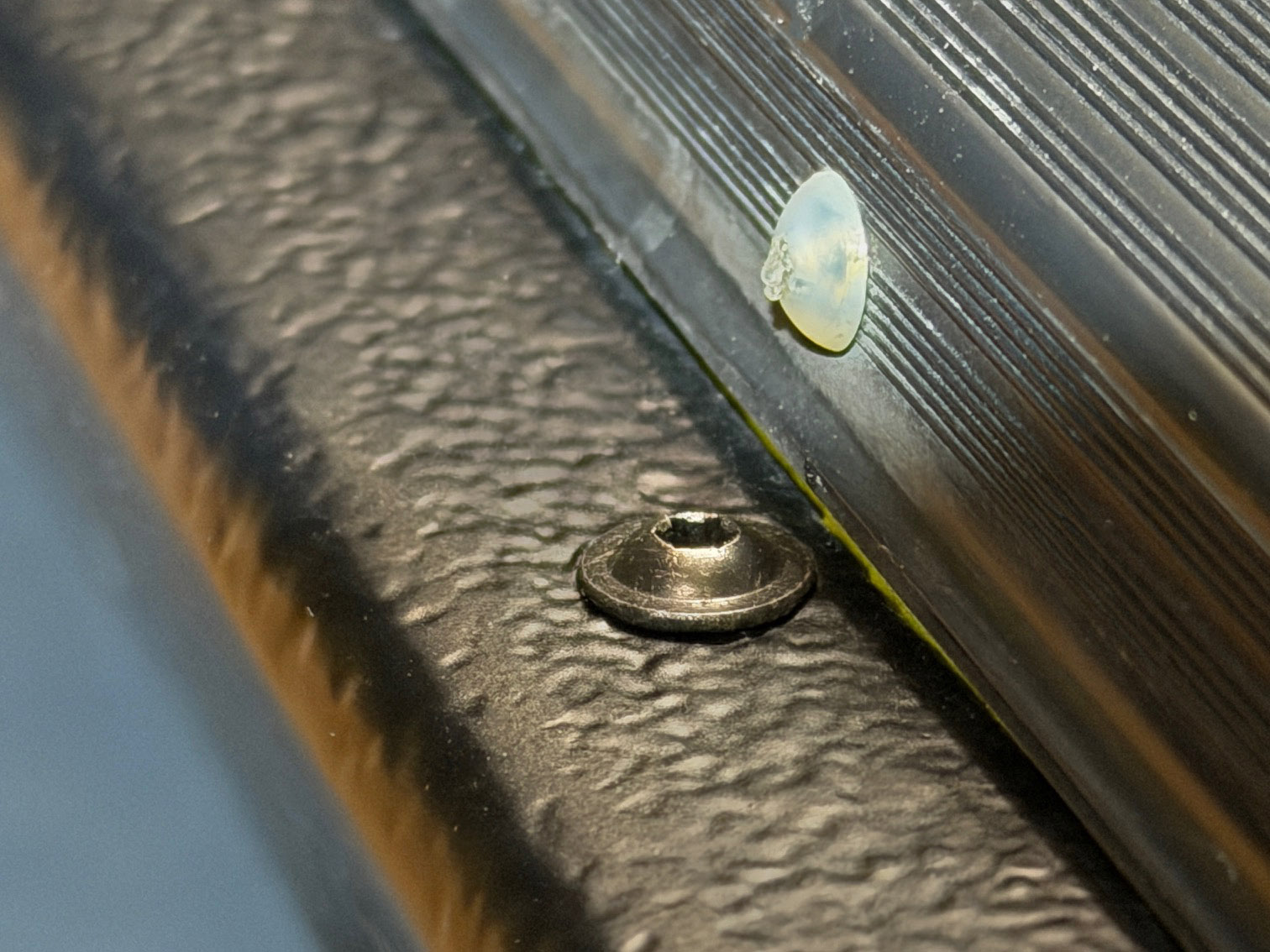

In the end I went with screws - because I found the right ones. 3.5mm x 13 long, black, low profile round head, and with a T10 torx driver. And to top it off under the black coating, the screws are... stainless. I didn't believe that at first, but lo and behold, you can't pick them up with a magnet. And I found them at the local Home Depot-style do-it store... (IMG:style_emoticons/default/biggrin.gif)
What's cool is that you just screw them right in - they're the perfect size, no drilling out of the body holes needed. The heads are lower than the rivets and a little wider.
There was a significant amount of crud under the rocker panels - I don't think they had been removed since the car was restored in 2011. I was happy to see that the longs were still nice and clean - no evidence of rust anywhere. Probably won't remove the rockers again that often, maybe once every couple of years...

I didn't take any pictures of the longs with the panels off. But basically they looked shiny like newly painted, just wiped off a light dusty coating with a damp rag. The 'crud' was actually accumulated on the inside of the rocker panels, when I took them off most of it just fell out on the floor and a light fiber brush got rid of the rest.
Below is a picture of a screw head in place and next to it there is a plastic rivet that holds on the sill cover for comparison. There was the same plastic rivet before where the screw now is. Mine are (were) all semi-transparent. The rivets are single-use only, you destroy them pulling them out.
