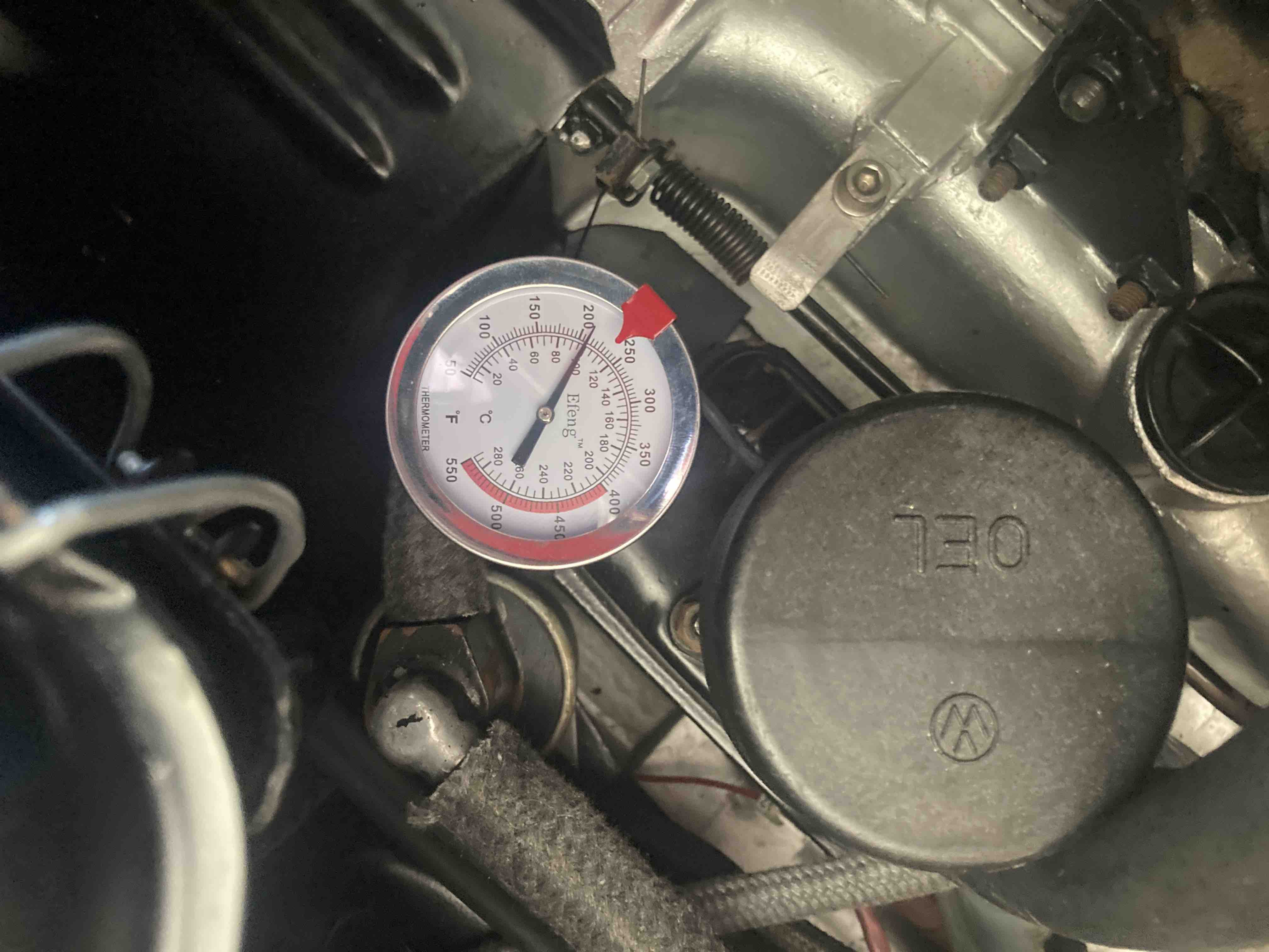

In preparation and hope that I pass my smog test I want to go on the So. Cal.Toy Drive in my 914 on Saturday (not sure if this is a good idea) .
I need to address what I think might be a high oil temp problem .
After driving around town for 30 minutes the photo shows my oil temperature oil gauge and a actual thermometer reading using a turkey fryer thermometer.
The needle on my console gauge gets very close to the red high mark and sometimes just about to cross into the red .
At this point the turkey thermometer reads ~216 F degrees .
My Dakota Digital head cylinder temperature reads 111C (231F) .
It is almost 80F here today in sunny So Cal. but this seems too high for me . What would be a normal reading for the oil temp gauge?
This is a newly rebuilt motor (less than 300 miles on it).
I did not replace the oil cooler (its original) but it was flushed and was clear.
The baffles are held open by spring tension since the thermostat is not working but I checked they were open by removing the coil and checking through the bolt hole. This should be ok until I get a chance to replace it .
If I pass my smog check tomorrow or Thursday I am hesitant to take the car on a long canyon drive , so not sure if I can attend the toy drive this Saturday.
Any thoughts ?

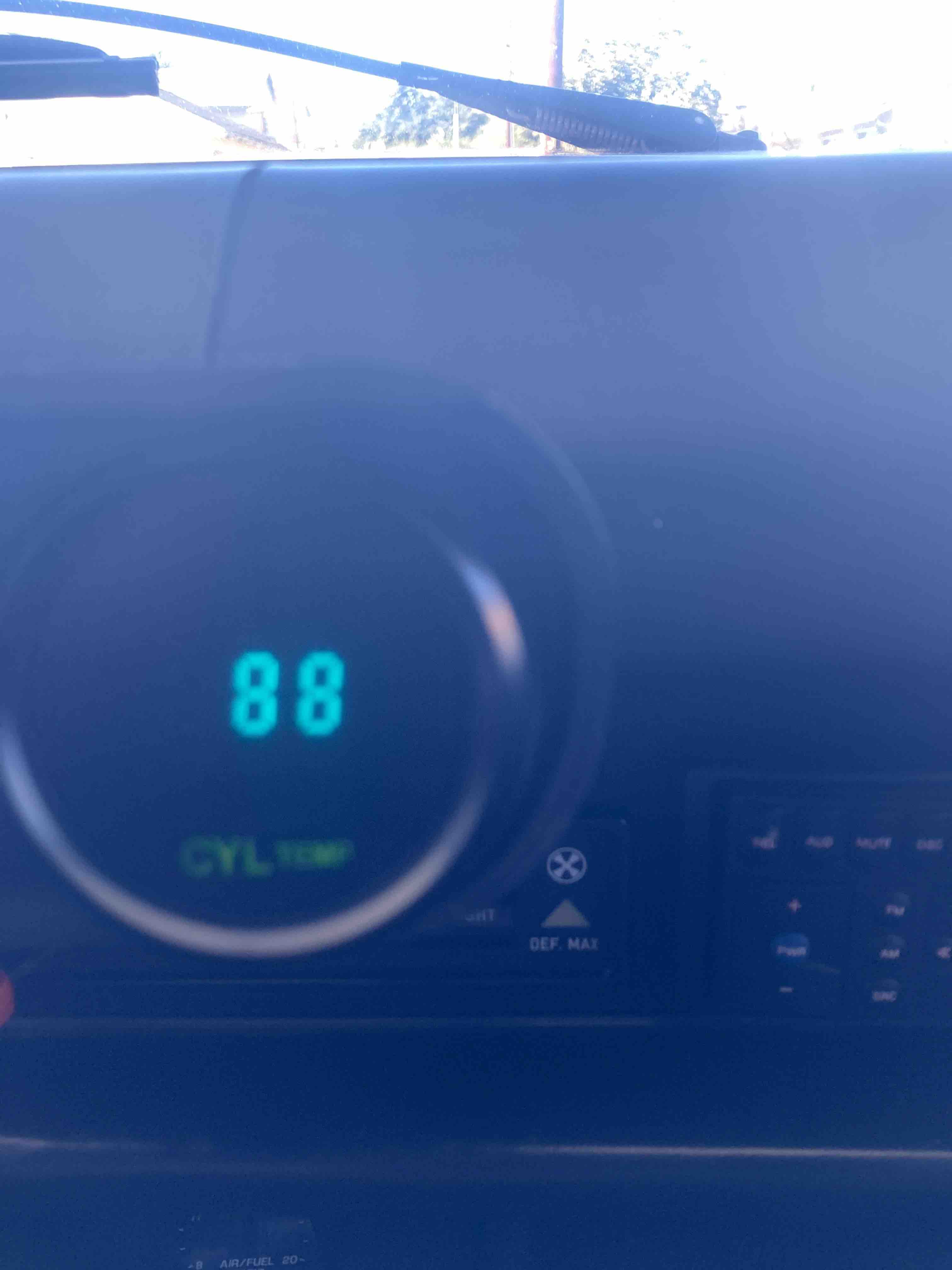

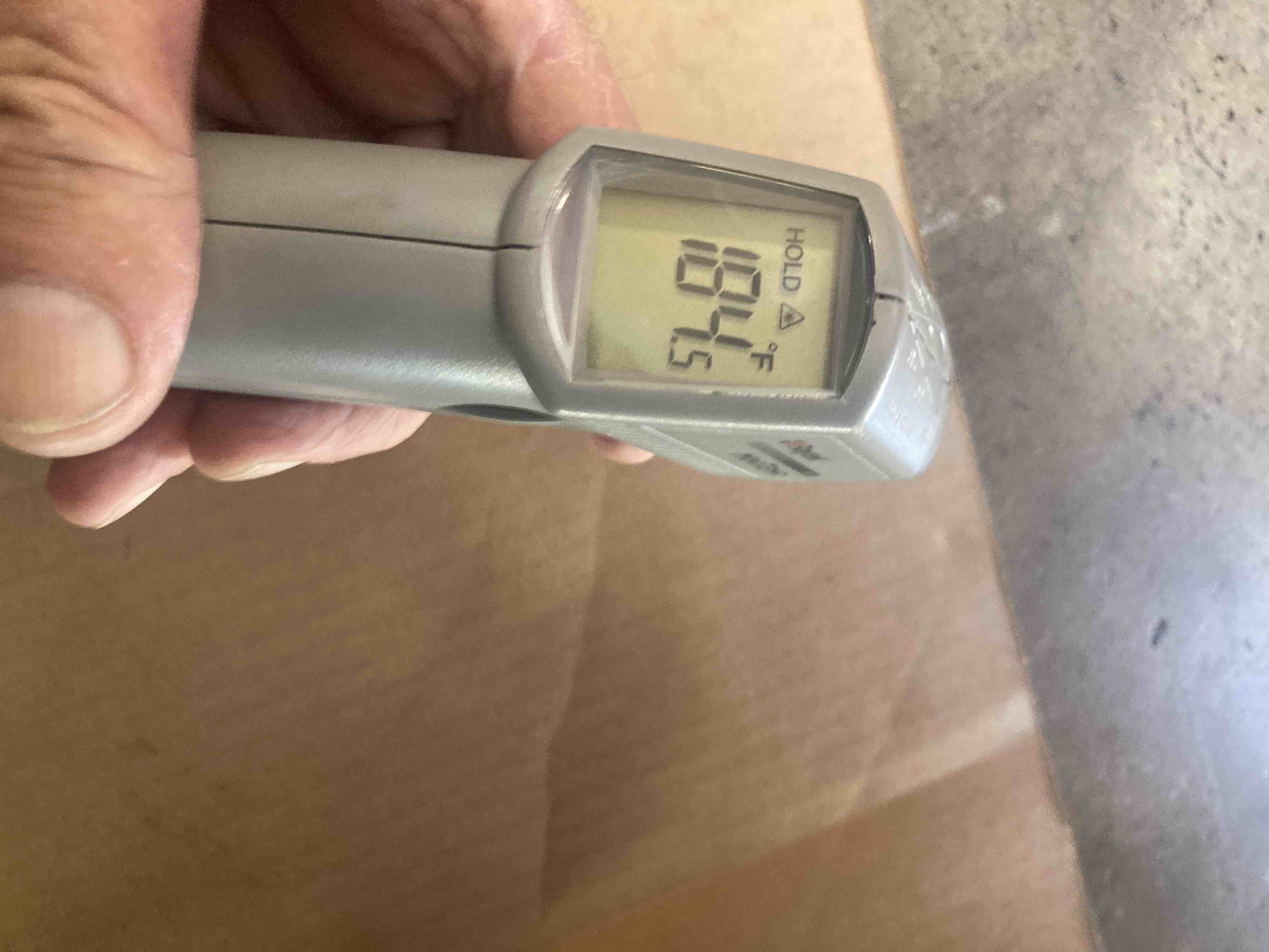

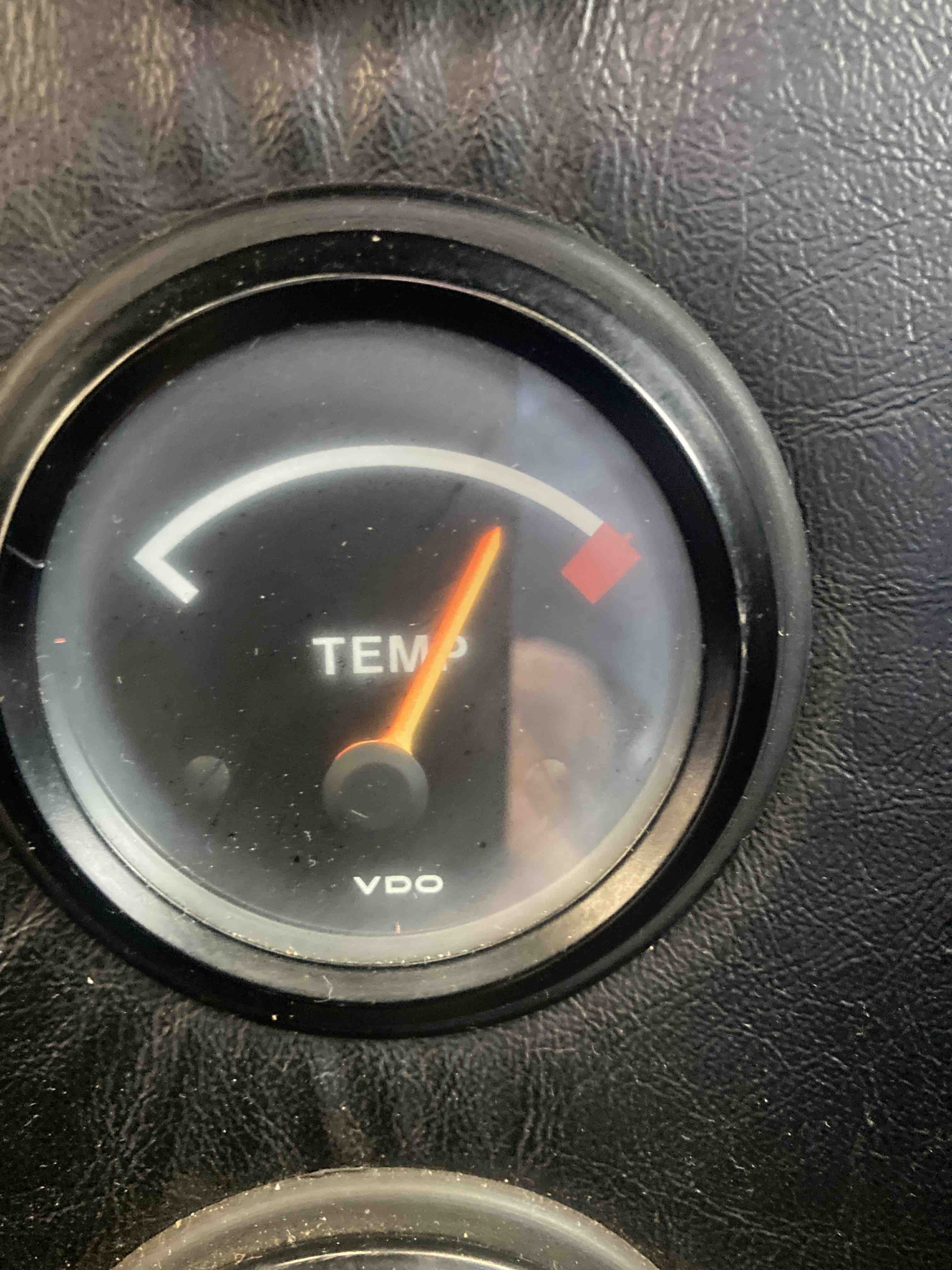

I made a couple of more temperature readings when I got home from my smog test today . I used the factory gauge , IR thermometer and a turkey deep fry thermometer as a replacement for my dip stick .
My CHT gauge is stuck in Celsius so 88=190.4F
I don't trust my IR thermometer which was a measurement of the bottom of the motor near the oil drain plug
And of course the factory gauge with a 200 C sending unit which shows ~ 245 F
There's a bit of confusion here for me so I will probably purchase a new sender unit and look for a new gauge .I changed the battery in the IR but that made no difference in the bad readings . I actually trust the turkey fryer thermometer
