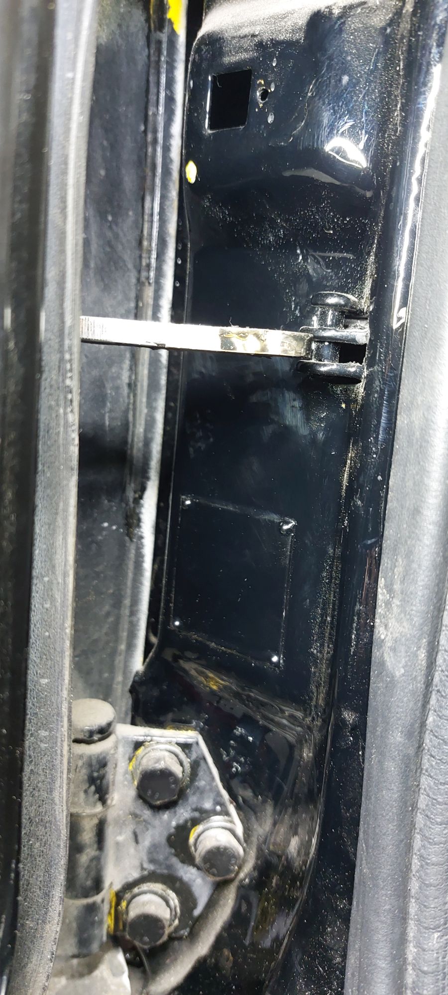

It would be helpful to have the body number... Normally on a "Karmann" plate on the drivers side forward door jamb, which also has the original color number. If you say that plate is missing, you might also find the body number stamped into the sheet metal of the floor of the rear trunk under the carpet. It's not extremely visible, here's what mine looks like:
The body number can be decoded to find the date of maunfacture. Otherwise, with the complete VIN number (including the last numbers blacked out), maybe one of the historians can provide more info.
Fantastic! Thank you for your reply.
Yes. Unfortunately "Karmann" plate is gone. But I´ll try to locate the stamped body number.

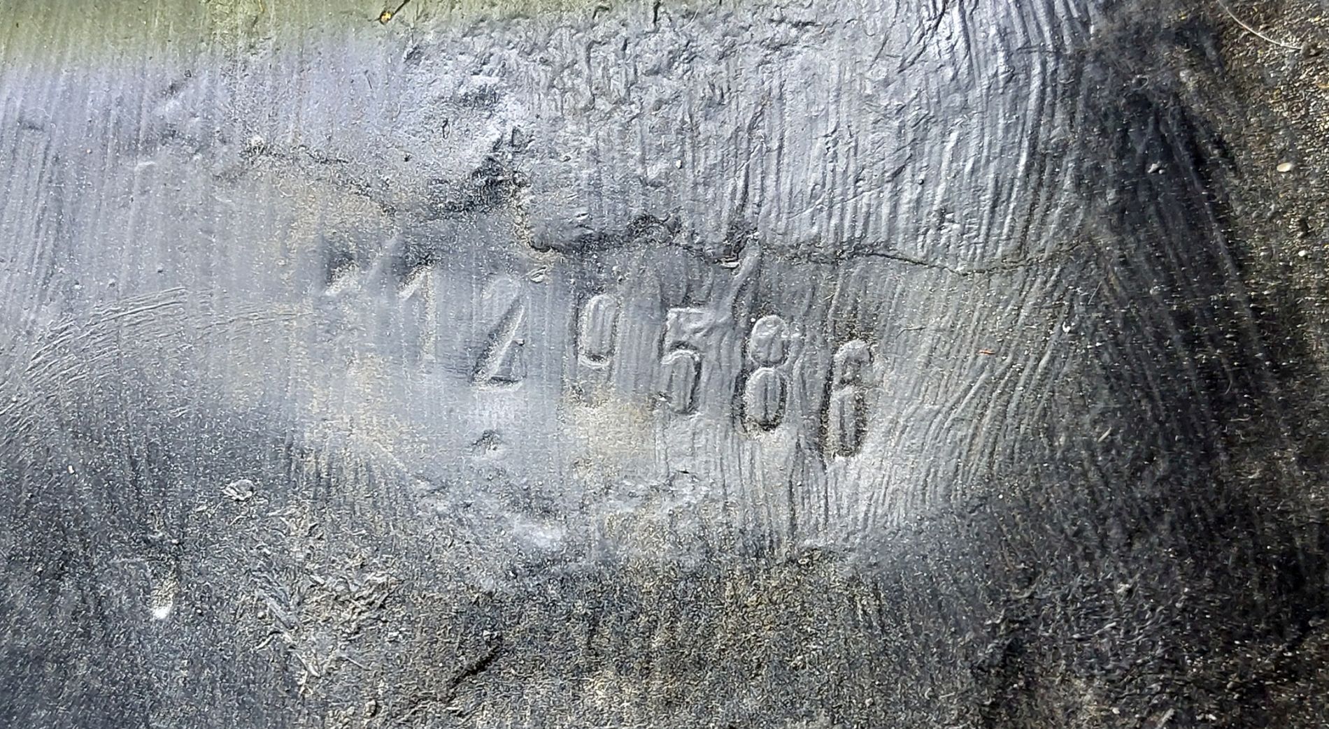

I´m very sorry, wasn´t sure if posting full VIN number is a good practice here.
Here´s my full VIN if "historians" can do their magic.
I managed to find my "Karmann plate" (IMG:style_emoticons/default/headbang.gif)
But was lucky with the stamped body number (IMG:style_emoticons/default/party.gif)
Do we think we can find some information about my car now, please? (IMG:style_emoticons/default/pray.gif)

chmillman   Is that 1129586? If so: Body number decode: 1129...   Dec 18 2025, 02:08 PM
wonkipop   Is that 1129586? If so: Body number decode: 112...   Dec 18 2025, 03:01 PM
chmillman   If so: Body number decode: 1129586 First numbe...   Dec 18 2025, 03:19 PM
wonkipop   If so: Body number decode: 1129586 First numb...   Dec 18 2025, 07:53 PM

chmillman   Doing a search in the 914World VIN database: 4712...   Dec 19 2025, 02:40 AM
