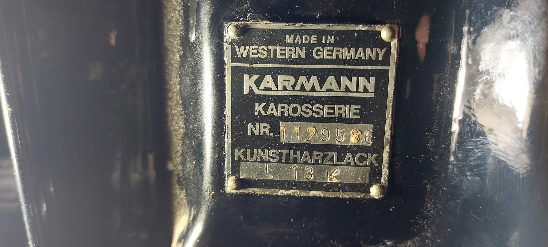

And the winner is ....... Mr. chmillman (IMG:style_emoticons/default/cheer.gif)
I also removed driver´s door and stripped Karmann plate. This confirms body number 1129586 (IMG:style_emoticons/default/smilie_pokal.gif)

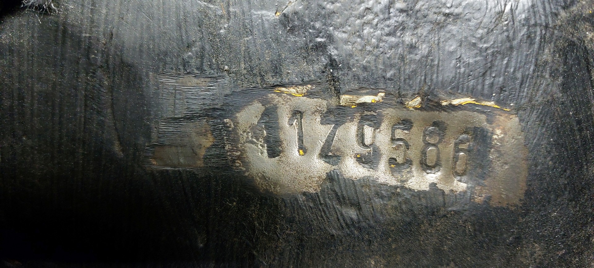

chmillman   Is that 1129586? If so: Body number decode: 1129...   Dec 18 2025, 02:08 PM
wonkipop   Is that 1129586? If so: Body number decode: 112...   Dec 18 2025, 03:01 PM
chmillman   If so: Body number decode: 1129586 First numbe...   Dec 18 2025, 03:19 PM
wonkipop   If so: Body number decode: 1129586 First numb...   Dec 18 2025, 07:53 PM
Pyetookh   [quote name='chmillman' post='3237353' date='Dec ...   Dec 19 2025, 12:04 AM

chmillman   Doing a search in the 914World VIN database: 4712...   Dec 19 2025, 02:40 AM
Pyetookh   And the winner is ....... Mr. chmillman :cheer: ...   Dec 19 2025, 11:29 AM
chmillman   Cool! OK, so I assume my original decode is c...   Dec 19 2025, 11:45 AM
Pyetookh   Cool! OK, so I assume my original decode is ...   Dec 19 2025, 02:36 PM
Pyetookh   Funny enough L13K is listed only for 1974 but my c...   Dec 19 2025, 02:50 PM
chmillman   Yeah, that is odd. L13K is also listed for 73, bu...   Dec 19 2025, 03:10 PM

wonkipop   @chmillman has better eyes than me. good thing i ...   Dec 21 2025, 04:58 PM
Pyetookh   [b]@[url=http://www.914world.com/bbs2/index.php?s...   Jan 5 2026, 03:55 AM
chmillman   Yeah, I would have a tendency to agree, nothing re...   Dec 22 2025, 03:47 PM
Pyetookh   Yeah, I would have a tendency to agree, nothing r...   Jan 30 2026, 12:21 AM
Front yard mechanic   Just fill in the wrong numbers with bondo and blam...   Dec 22 2025, 04:17 PM
wonkipop   if both those cars, the 71 and the 73 (burnt) are ...   Jan 5 2026, 04:27 PM
