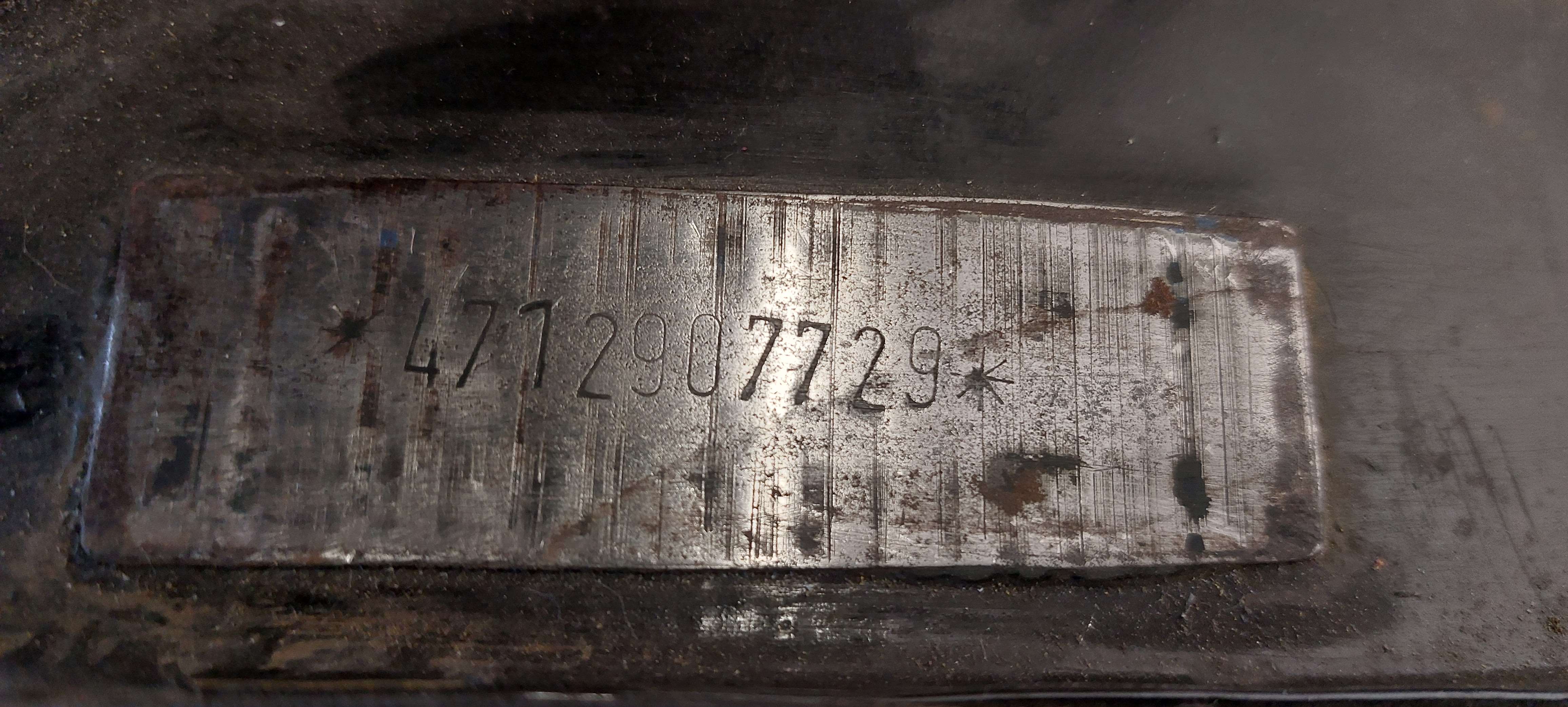

Funny enough L13K is listed only for 1974 but my car is 1971. Can someone explain it, please?
This car has proper VIN and rivetted label so it must be genuine 1971 (IMG:style_emoticons/default/popcorn[1].gif)

chmillman   Is that 1129586? If so: Body number decode: 1129...   Dec 18 2025, 02:08 PM
wonkipop   Is that 1129586? If so: Body number decode: 112...   Dec 18 2025, 03:01 PM
chmillman   If so: Body number decode: 1129586 First numbe...   Dec 18 2025, 03:19 PM
wonkipop   If so: Body number decode: 1129586 First numb...   Dec 18 2025, 07:53 PM

chmillman   Doing a search in the 914World VIN database: 4712...   Dec 19 2025, 02:40 AM
Pyetookh   And the winner is ....... Mr. chmillman :cheer: ...   Dec 19 2025, 11:29 AM
chmillman   Cool! OK, so I assume my original decode is c...   Dec 19 2025, 11:45 AM
Pyetookh   Cool! OK, so I assume my original decode is ...   Dec 19 2025, 02:36 PM
Pyetookh   Funny enough L13K is listed only for 1974 but my c...   Dec 19 2025, 02:50 PM
chmillman   Yeah, that is odd. L13K is also listed for 73, bu...   Dec 19 2025, 03:10 PM
