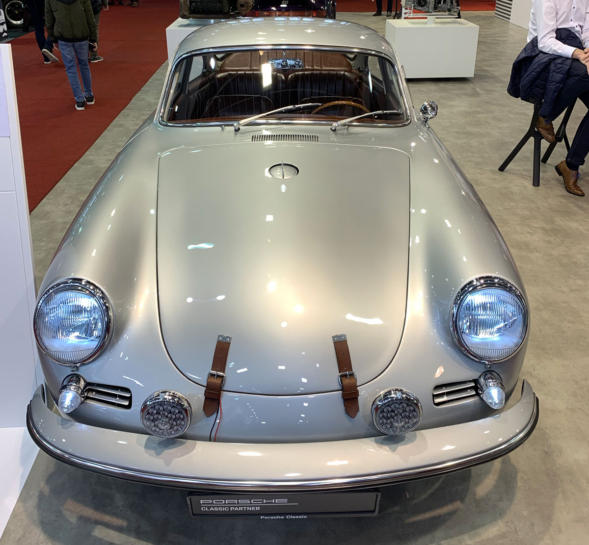

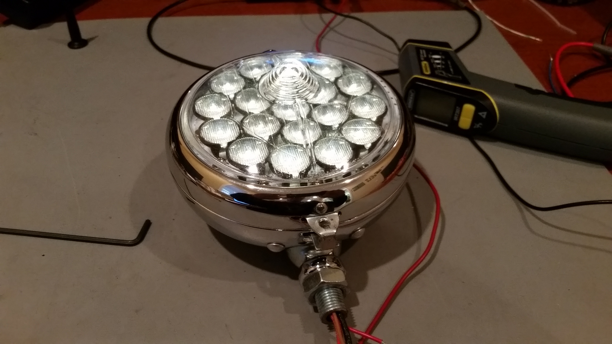

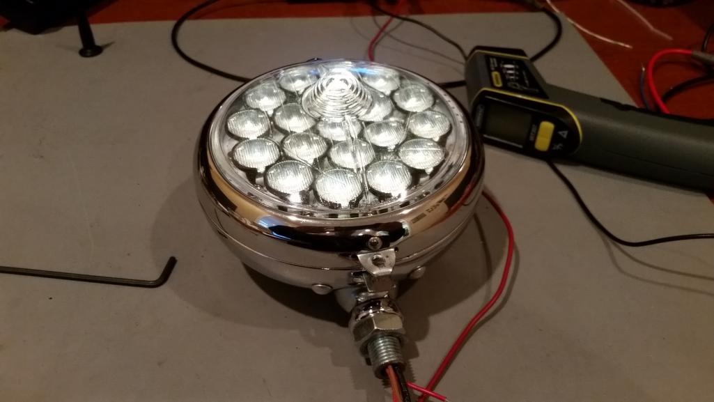

Yes, great illustrated process! I had no idea there was that much work involved. I didn’t quite understand the purpose of the “conformal coating” that you put on and afterwards seems to be gone again… And, I have asked this before, but are those SMD LED’s available in warmer color temperatures? Would be good for the “classic” look. In my case the power savings would be even greater as the accessory H3 lamps here are 55W, not 35W. Yes, they are available as warm as 2700K. I designed the Marchal driving light below for a 356 for guy in Europe who wanted it for his uncle. He wanted a warm white at 3000K. Turned out they were way warmer than the lights his uncle had on the car and they don't use them that much. Attached thumbnail(s) |
